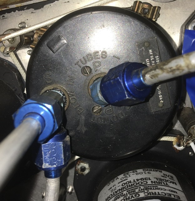

I’m gonna try first what Neal says. But after examination I see the static line is daisy chained airspeed then vsi then altimeter. So if I disconnect the airspeed will I need to put a plug on the line to keep the static line closed. See picture. The line branching off to the left is the line to VSI and altimeter.

Yes you would have to plug it if you still want the altimeter and VSI to draw from the static port. However, both the altimeter and VSI will work just fine in these little airplanes with cabin static pressure.

If it's easier, just disconnect all of them. It's not like you're going to be shooting an approach to minimums anytime soon! ;)
