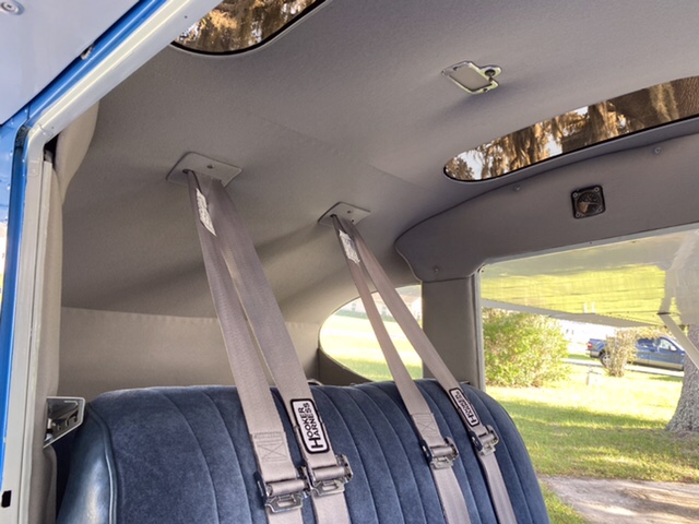

We recently installed the Hookers in my 48 140. Turned out really nice...just follow the install instructions

We removed the headliner for the install and replaced it with a new Airtex unit.
That being said, if your headliner is good ( and hasn’t been glued in every where like mine was) it’s a fairly straightforward process to drop it from the front and reinstall it. Lorraine Morris’ video is worth its weight in gold for the process.

Where did you get the little panels that go around the belts where they stick through the headliner? Also did the airtex liner fit well? I've seen a lot of comments saying that the parts that cover the wing root are pretty wonky.

Those particular pieces came with the air Tex headliner and we covered them with the material that we cut from the skylight openings. That being said, it’s just lexan and very easy to make yourself which is handy if you happen to over cut the slit in the headliner.
As for the Airtex headliner, it fit very well. The only tedious part came in laying out and cutting the skylight openings. We did have to manipulate the wing root covers for a better fit around the fuel gauges. I also recommend finding a welding supply house and buying a couple of stainless steel welding rods for the headliner stay rods.
