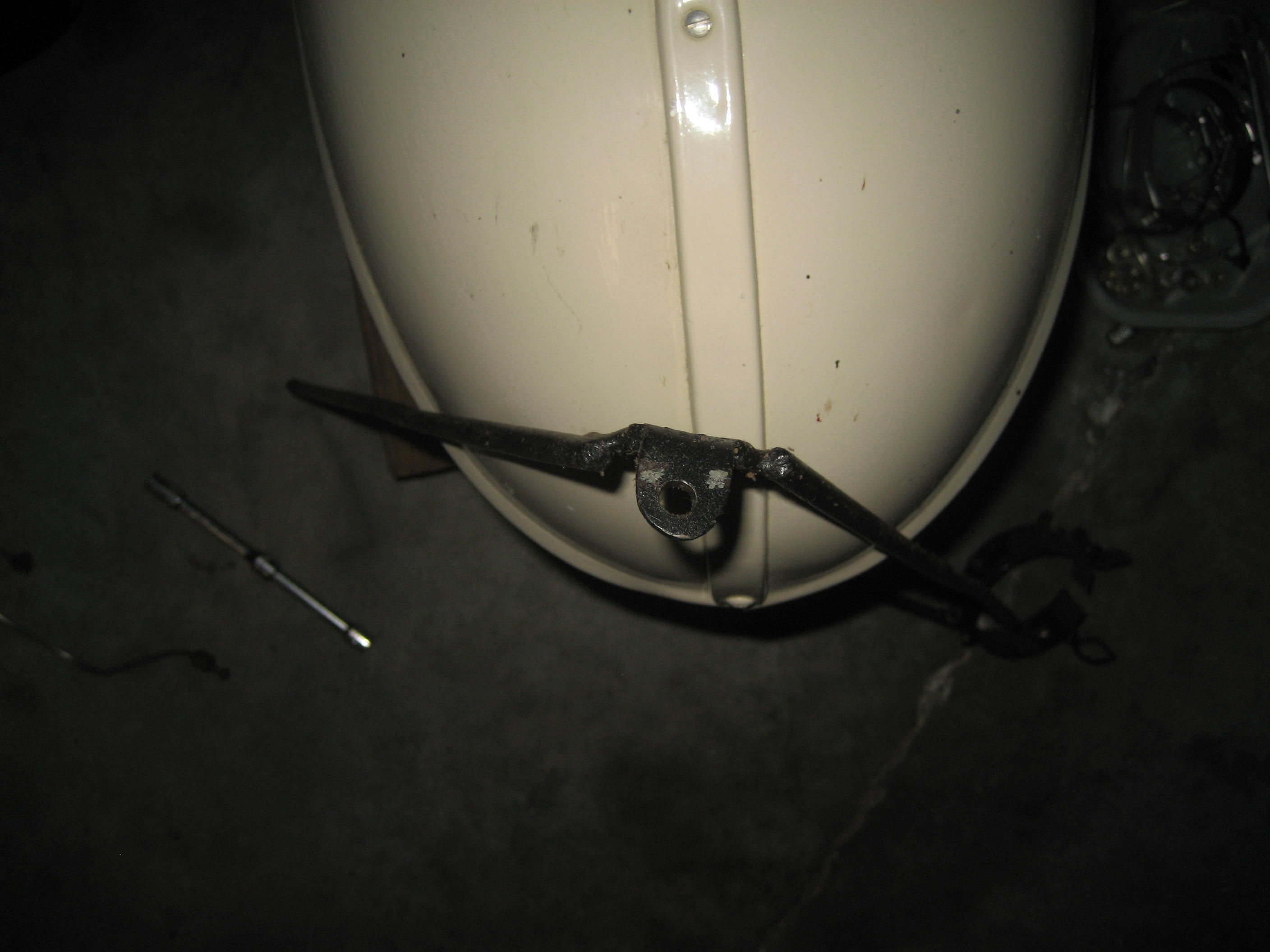

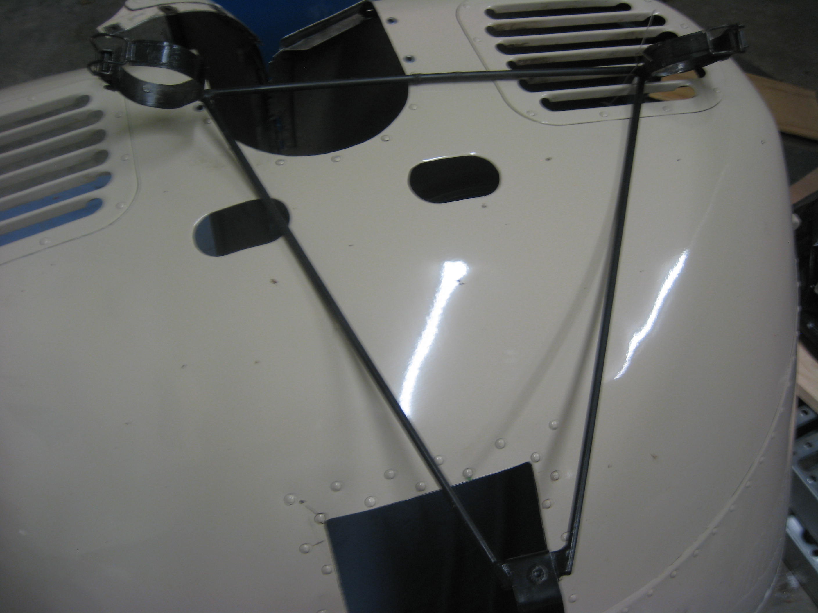

Would someone mind taking a picture of where the exhaust brace attaches to the exhaust pipes?
I assume it’s attached by a hose clamp?
Re: More exhaust questions
a64pilot wrote: ↑Tue Dec 15, 2020 6:00 pm Would someone mind taking a picture of where the exhaust brace attaches to the exhaust pipes?

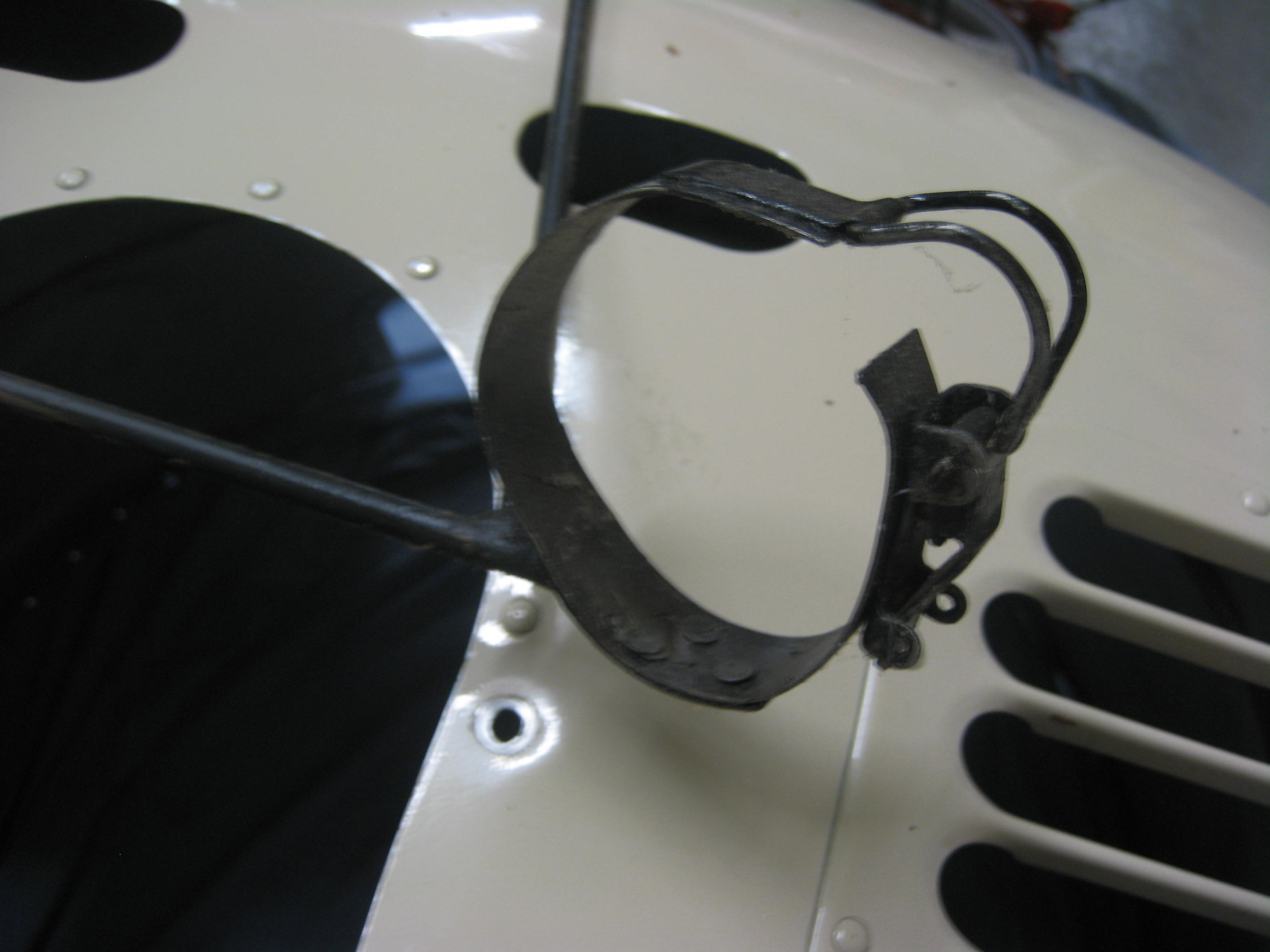

I'd be glad to...but, I have my accessory case off right now, engine hanging on hoist, and the bracket just hanging over the gascolator. I do have a close neighbor with straight exhaust and a bracket in place...should be able to get a pic of his in the next day or two if someone doesn't respond with one here before. Yes -- if using the Wag bracket most use a good quality hose clamp with cushion ("exhaust wrap") 'twixt bracket and pipe. The OEM brackets came with a "latching, spring loaded" clamp attached (see pic). Mac

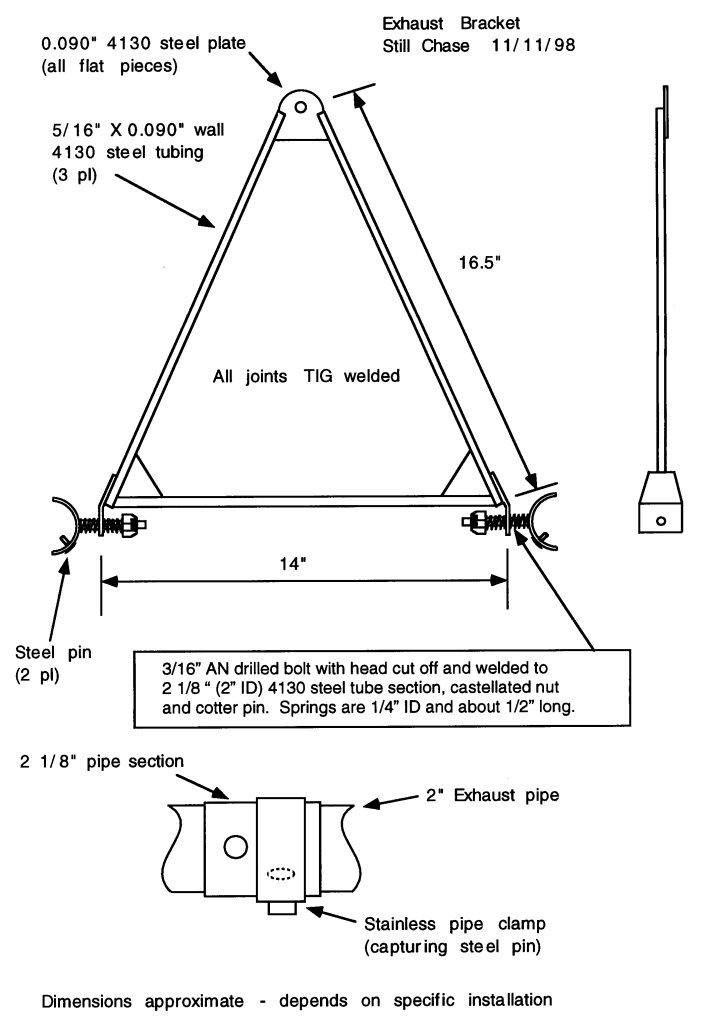

...further info. on the exhaust bracket -- here's a drawing/description of an "owner produced part" shared by fellow member Still Chase a few years back. Still's "design" seemed to go a long way in handling the intended dampening of vibration & movement of the exhaust and also helped prevent cracking of the bracket (detail not shown is that the 5/16 tube needs to be slightly offset at the upper connection to clear the motor mount -- pic, below -- will make sense as you mount the bracket. The Wag bracket doesn't have the offset incidentally, but can be slightly bent to clear). Mac

So I’m assuming that the bracket will attach to the shrouds and not at the end where the pipes are? YES. I've seen some attached to the pipes -- not correct, of course, but it was due to the muffs being "gone" from wear down there.
I’m going to Jax where the boat is and I have some fiberglass cloth I’ll get for padding. That should work. The OEMs had asbestos weave inside the lower ends of the muffs as well as at each of the tops @ cylinders -- the muffs were protected from wear & the clamps were sufficiently "cushioned" by that. Now, it seems a lot of folks use high temp wrap both inside muffs and also under the clamps. With your experience & expertise you'll get a good feel for what's needed there as you put it all together.
So I’m assuming the brace goes on the rearmost stud for the oil tank and clamps to the shrouds just wherever it matches up, and I may have to bend a leg to get it to clear the engine mount? Yes. One thing to be aware is IF that stud is drilled the vibration from the bracket can cause the stud to break at the hole...IF the nut is at or or above the hole when tightened...may be worth installing a non-drilled stud while you're at it. Getting to that stud with the bracket on to tighten is "fun", too, so you may want to use an alternate nut there -- John C. has suggested a part # in another post, I believe. The bracket may/may not be close to the mount tube, but if clearing by 1/4" or more it'll prob be OK -- just be sure any "bending" doesn't leave it under stress that could promote cracking
