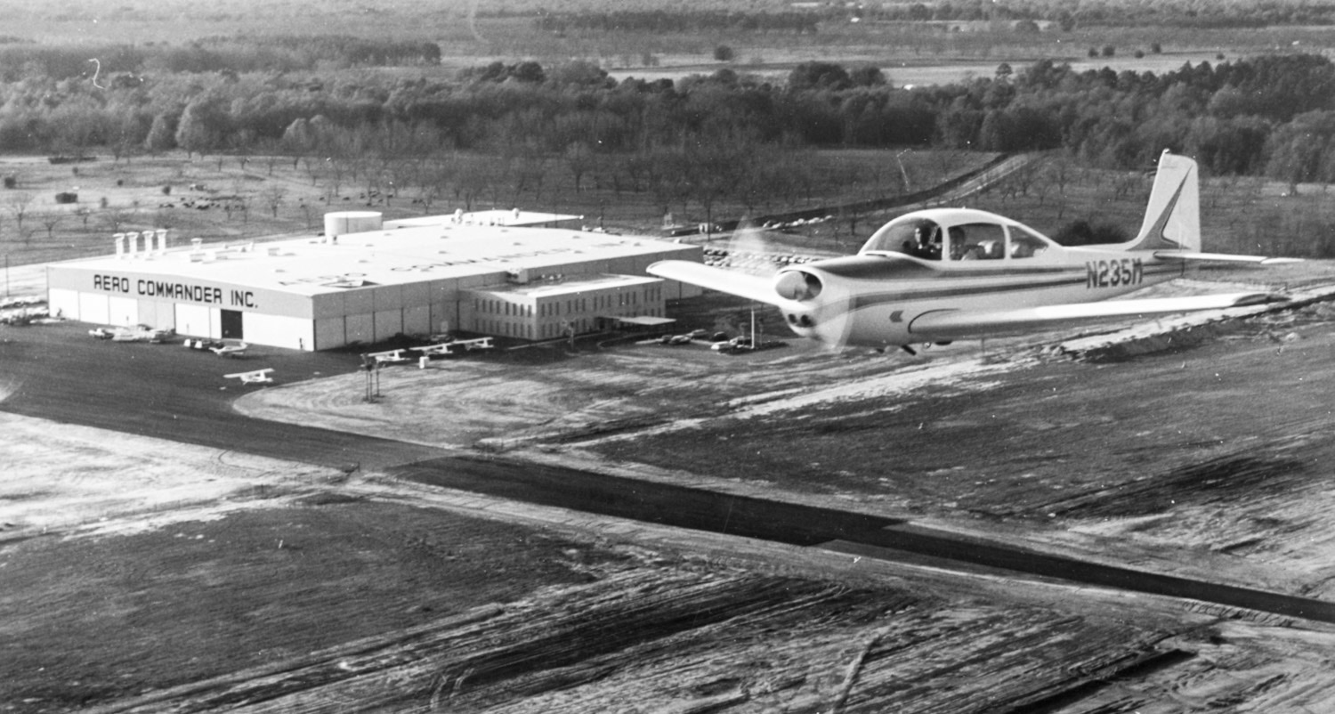

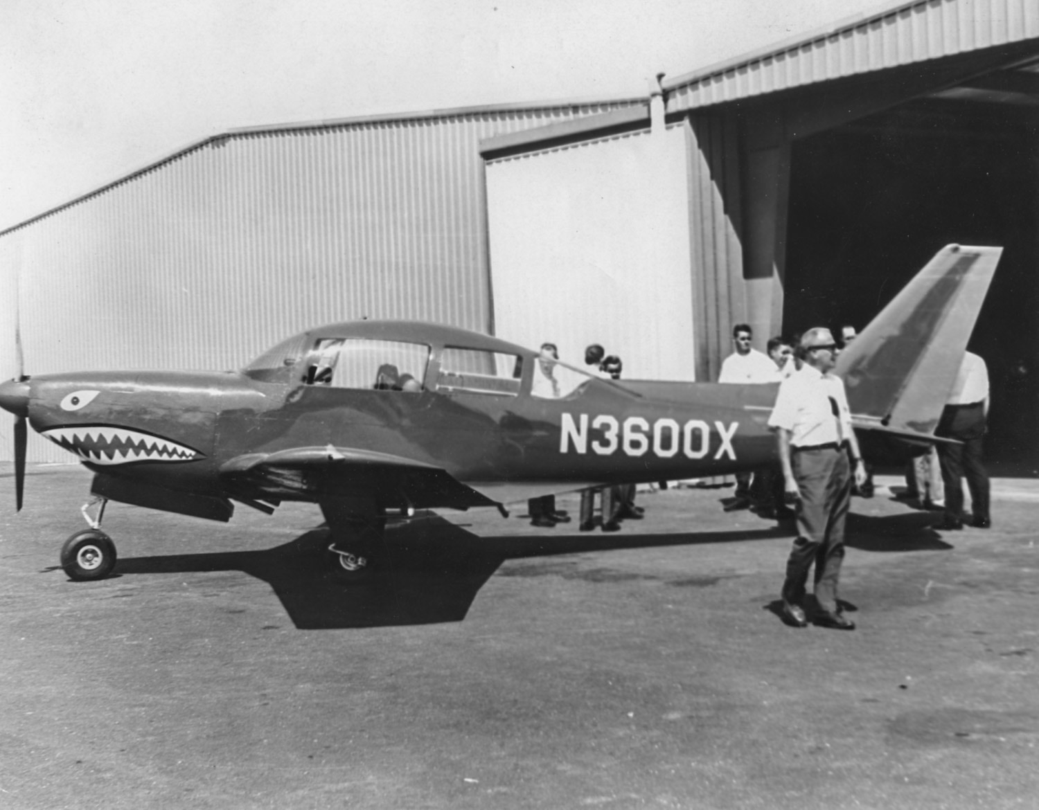

Ref Hoerner tips and drag reduction / speed increase.
I was looking for a Meyers 200D for awhile as a traveling airplane, for those unfamiliar with the Meyers almost all were built in the Rockwell Albany Ga plant and were exceedingly expensive to build so they weren’t successful, but they were fast, I believe still may be the fastest GA non turbo aircraft, every year they still win races. Faster then the S model Bonanza, which is the fastest Bonanza
Their factory wing tips were identical to ours, simple round elliptical tips, so being that so many were racers, installation of Hoerner tips was pretty common in order to increase speed.
They did look Modern, they had a neat plexiglass cover that moved the lights under the surface leaving the tip smooth.
However there was no increase in speed or any other performance increase, it simply made no difference.
I couldn’t find a Meyers I was comfortable buying, so I ended up with a Mooney M20J.
Mooney as you know are known as efficiency kings, nothing goes faster on less fuel then a Mooney. Mooney went through a few different wing tip designs for their Laminar flow wing, older Mooney’s have no tip. the wing simply ends.
When Lopresti came in and developed the J model with all of its “speed mods” he added an interesting up swept tip design, when pushed to quantify the speed increase of the wing tip he starts talking about esthetics, because the truth is, there is no increase in speed,it just looks cool, and cool sells.
He did push the J to 201 MPH at seal level on only 200 HP, but the tips didn’t help.
