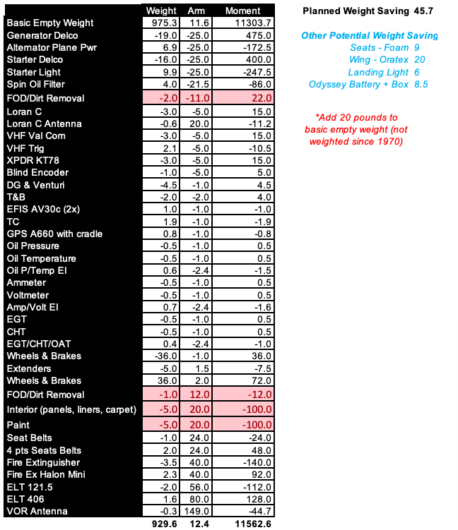

maverick_fa wrote: ↑Thu Oct 14, 2021 4:56 pm I'll always be out of the forward tolerance unless I'm full fuel. (REF. IMG_1605, IMG_1606)
*This is with the current empty weight CG at 11.69
I'll be always outside of tolerance with 3.5g of fuel (minimum VFR + unusable fuel) unless the empty weight CG is >=12.7 (REF. IMG_1607)
Yeah, I know. I already ran some numbers with your spreadsheet. I don't have an answer for you, other than a possible error in the spreadsheet itself.

So, I'd suggest you level it using the horizontal overlap that runs the length of the fuselage, hang a plum-bob off the wing leading edge and measure to your mains and tail wheel. From this you can calculate the C of G.
I'll definitely do that.
Maybe but my spreadsheet is working for all other AC that I flown. I also did the manual calculations with the W&B on the website & I end up with the same result... :shock:
I'll do the troubleshooting probably next week when I'll get the airplane.

You might also check the chain of calculations from the last weighing as things were added and subtracted. I have seen lots of small errors in these updates.

I decided to put my 140 on diet from the instrument panel forward & I expect to get in the CG tolerance range when I'll be done with the mods as per my calculations (for entertainment use only).
I'll properly weight my AC (hopefully this summer)... the last time that she was officially weighted was in 1970... :roll:
She probably weight way more than I was thinking... :oops:
FYI, she was already with a forward CG back in the 1970... since them a huge 35A generator have been added on the top of the heavy prop (69CK-0-48L)
