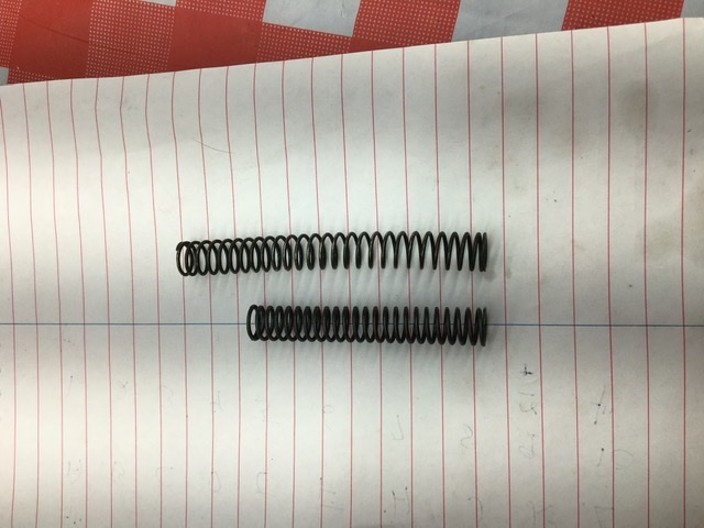

Well it WAS the spring. I ordered the spring from Fresno air parts, like $9 for the spring and $12 shipping.
When I removed the spring and looked at the new one I thought no way they sent me the right spring it’s way too short, but after checking it, there was significant compression even with the short spring so I thought may as well run it up and see if I have oil pressure. On run up at 1000 RPM I have 45 PSI, 60W oil cold as in 80F or so.
Takeoff and climb she holds the 45 until about 175 or so when it drops back to 40 ish, I had to hang it on the prop climbing for it to get to 200 where it held 35 to 37, it will hold 30 at 1700 RPM with 200F oil. So I think my problem is fixed, it’s a little over 90F on the ground now and humidity real high as there are popcorn showers all around, so 190 cruise I’d say is normal as it’s 90 at 1,000 MSL.
Pic is of the two springs, long one came out, short one is the correct spring, no shimming on either.
I theorize the long spring didn’t have enough tension and was almost completely stacked up, and with engine running the plunger was off its seat and the spring stacked up, so it would hold enough pressure until it got thin, then pressure would come down. Normally the spring would close the plunger to keep pressure up, but the incorrect spring didn’t have enough tension.
My theory anyway, but the learning point for me is if your having oil pressure problems, try a new spring, they are only $9.

My bet is someone thought stretching the spring would make it work better...
