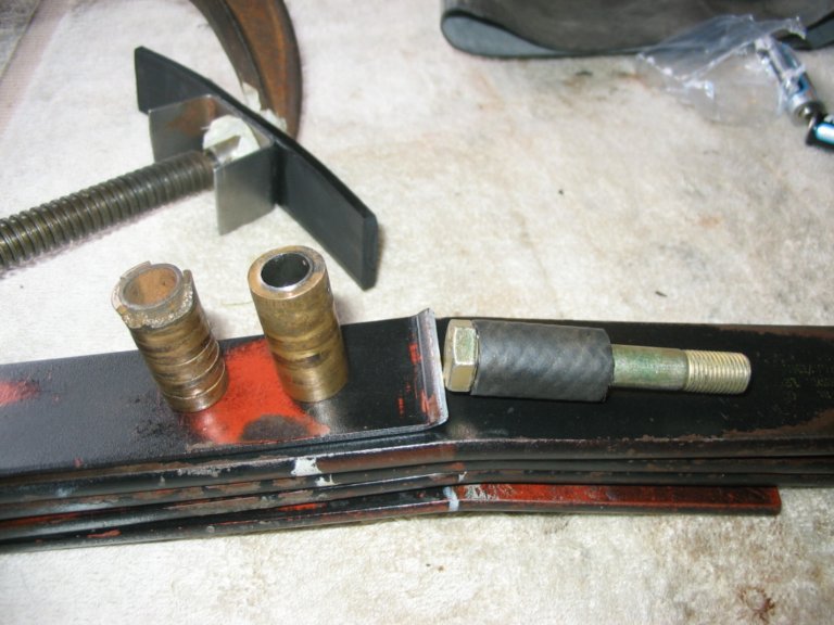

As we are grindng away on the subject, here's what I had moons ago. A metal bushing that was deteriorating, a homemade (by me) metal bushing, and the final radiator hose piece, which works super. In the background I'm gluing up a 0442124 Assembly Strip-Tailwheel Spring Abrasion. I did have the incorrect double-bend set on my early SN 140, may be why there was a metal bushing in there, who knows.
- IMG_1431.JPG (81.29 KiB) Viewed 4261 times
