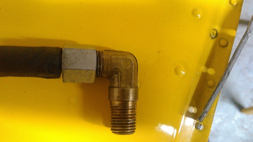

So, I pulled the line off the venturi. Here's the fitting attached to the venturi.

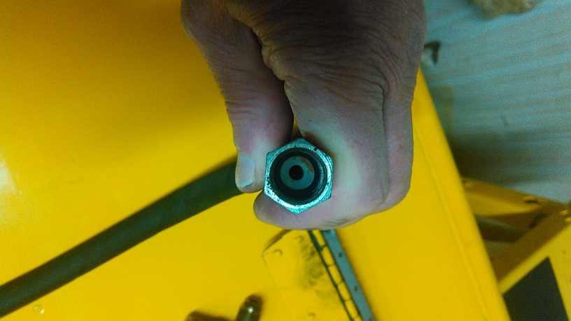

Here's what the inlet to the fitting looks like:

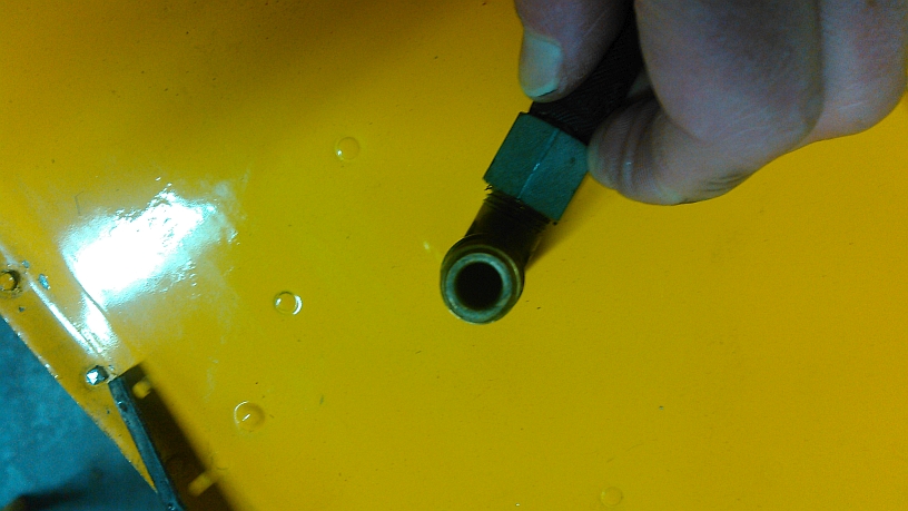

I removed the hose from the fitting and found this:
I wasn't able to measure this directly, but a 5/32" drill bit fits and a 3/16" bit doesn't.
The port on the venturi is 1/4 pipe, so I'll be putting a 1/4 to 3/8" pipe adapter and a 3/8" pipe to 5/8" hose vacuum fitting in place of this mess. 3/8" pipe to 5/8 hose into the regulator and individual 1/4" pipe/3/8 hose from the regulator to the instruments and then on to the filter. I'm reusing whatever fittings are on the DG now, since it works, and replacing the AH fittings with RAPCO vacuum fittings.
