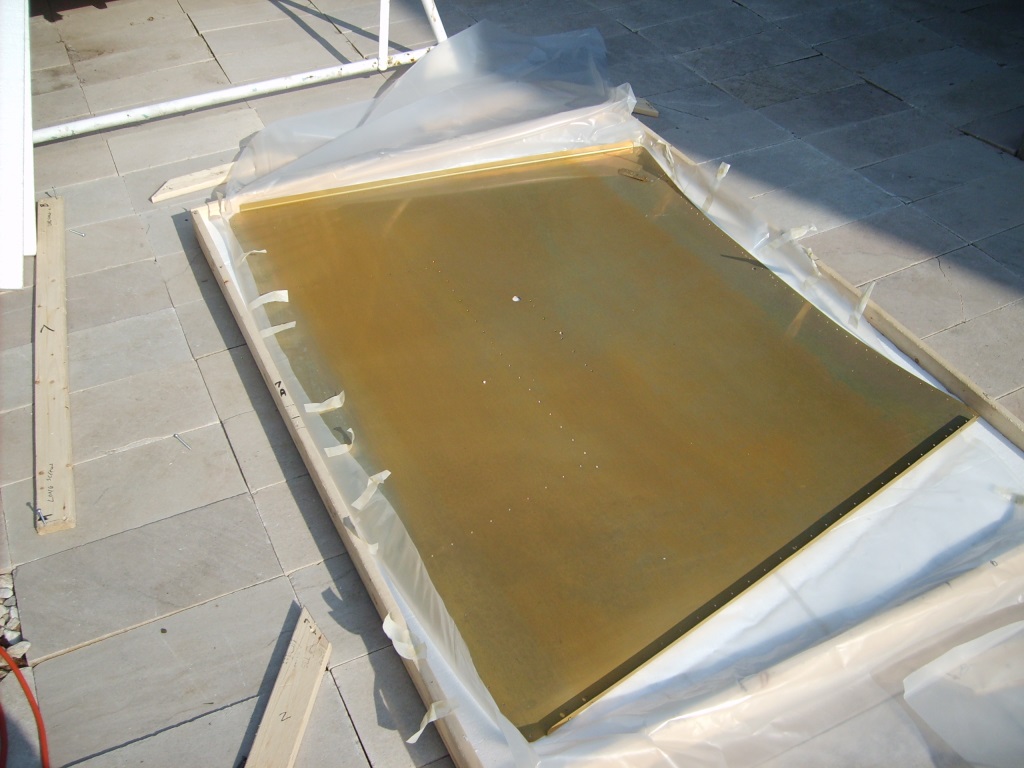

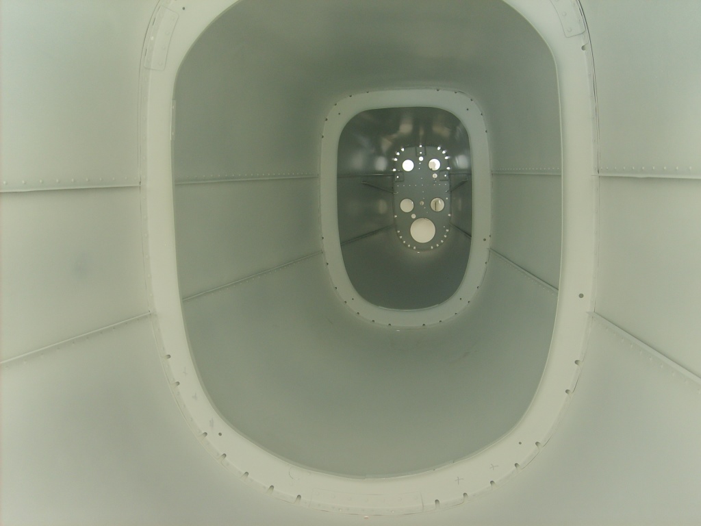

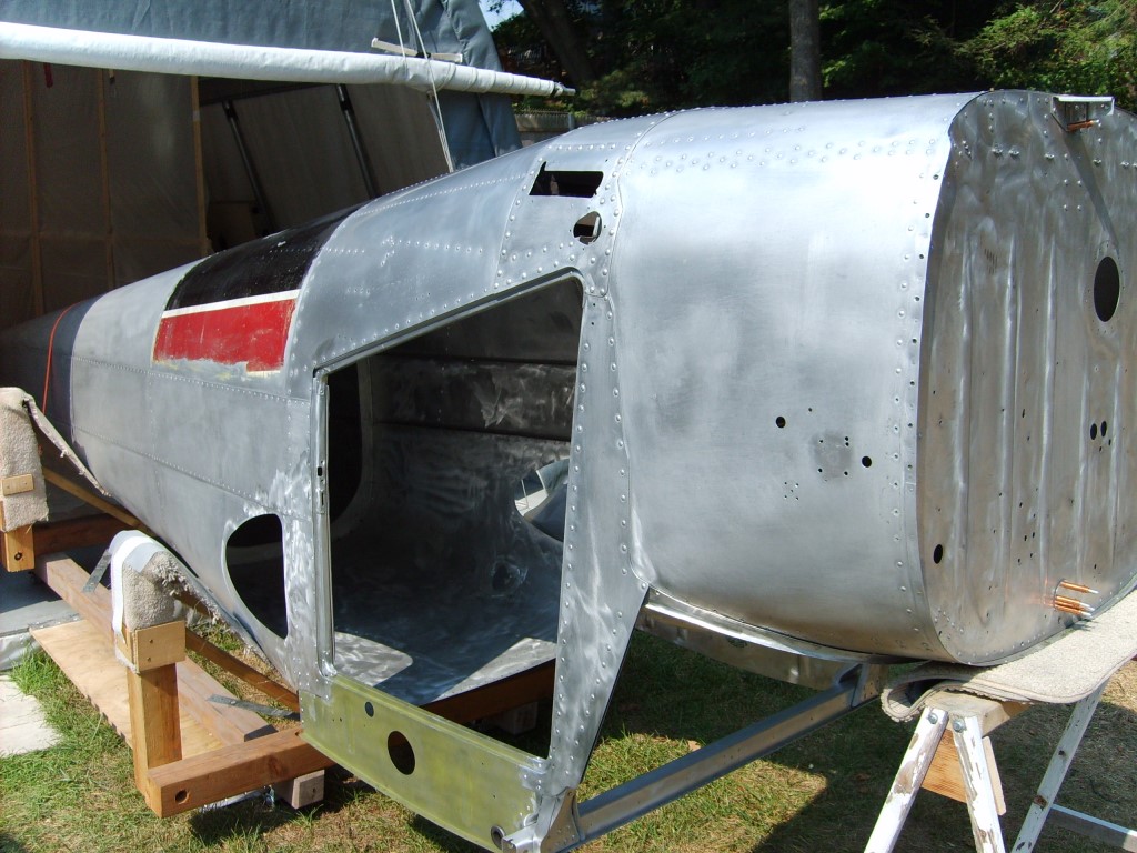

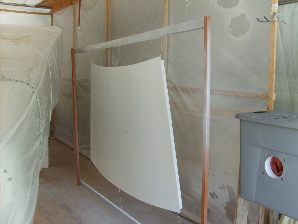

Ten years ago, I had to replace one of my belly skins during my initial build, i.e., Cessna P/N 0411134, STA 56.69 to 95.00, Illustrated Parts Catalog Fig. 23-7 pp. 43 and 45. The particular skin was 0.032 in thick, 2024T3 (formerly 24ST). I noticed that some of the upper fuselage skins appear to be 0.040 thick material though (except for roof which is 0.032). I had to replace the roof too as a separate project.
After removing the dented old belly skin, I match drilled the new skin to it. Fit perfectly. Match drilling works really well despite all of the holes that could contribute to tolerance stack-up. While the skin was out, I had wood braces to keep the fuselage from bending. Being a large part, I brought it to a professional Alodining service as at the time I did not know how to Alodine such a large part, but I have since figured out a way by improvising shallow basins lined with polyethylene.
My IA and I filed a Form 337 for this repair as it was a major repair. See photos.
PS-my dad was 83 years in photos. He is 93 years now and still working with me.

- Belly Skin Prior to Replacing.JPG (246.86 KiB) Viewed 5293 times
- Belly Skin back from Factory Alodining.JPG (227.4 KiB) Viewed 5293 times

Re: 140 loooong dent. Belly skins
More photos.
- Belly Skin and Tailcone after riveting and priming.JPG (176.37 KiB) Viewed 5293 times
- Belly Skin after Epoxy Primex.JPG (195.13 KiB) Viewed 5293 times
