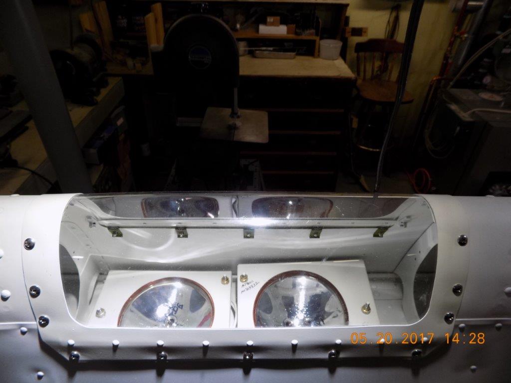

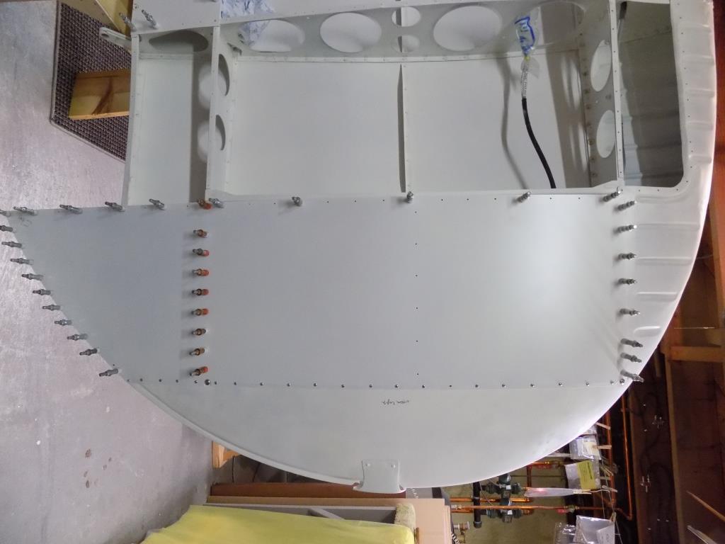

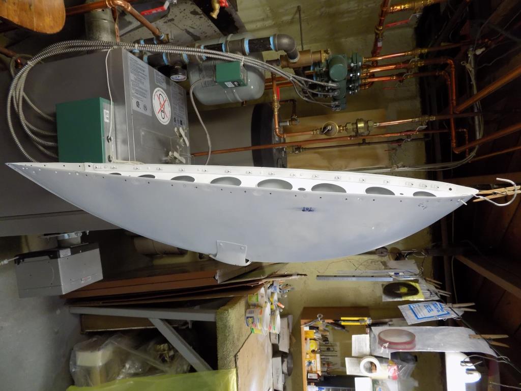

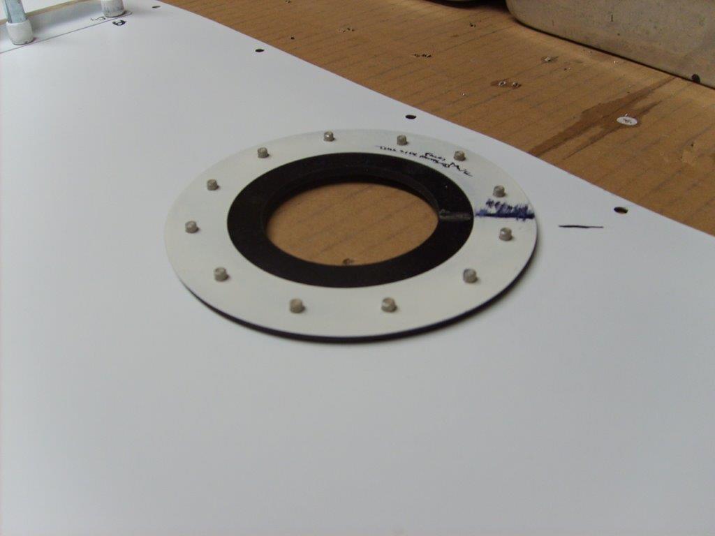

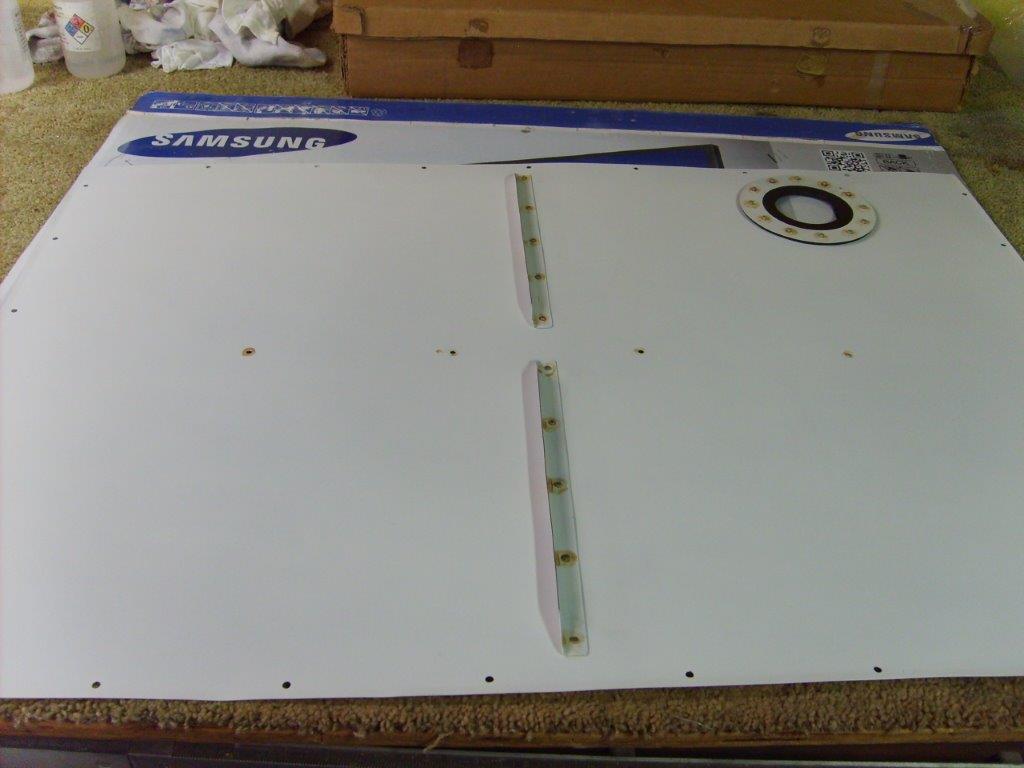

Some photos of the fuel cell bay cover
- S5005264.jpg (76.2 KiB) Viewed 6601 times
- S5005167.jpg (62 KiB) Viewed 6601 times
- S5005159.jpg (42.52 KiB) Viewed 6601 times

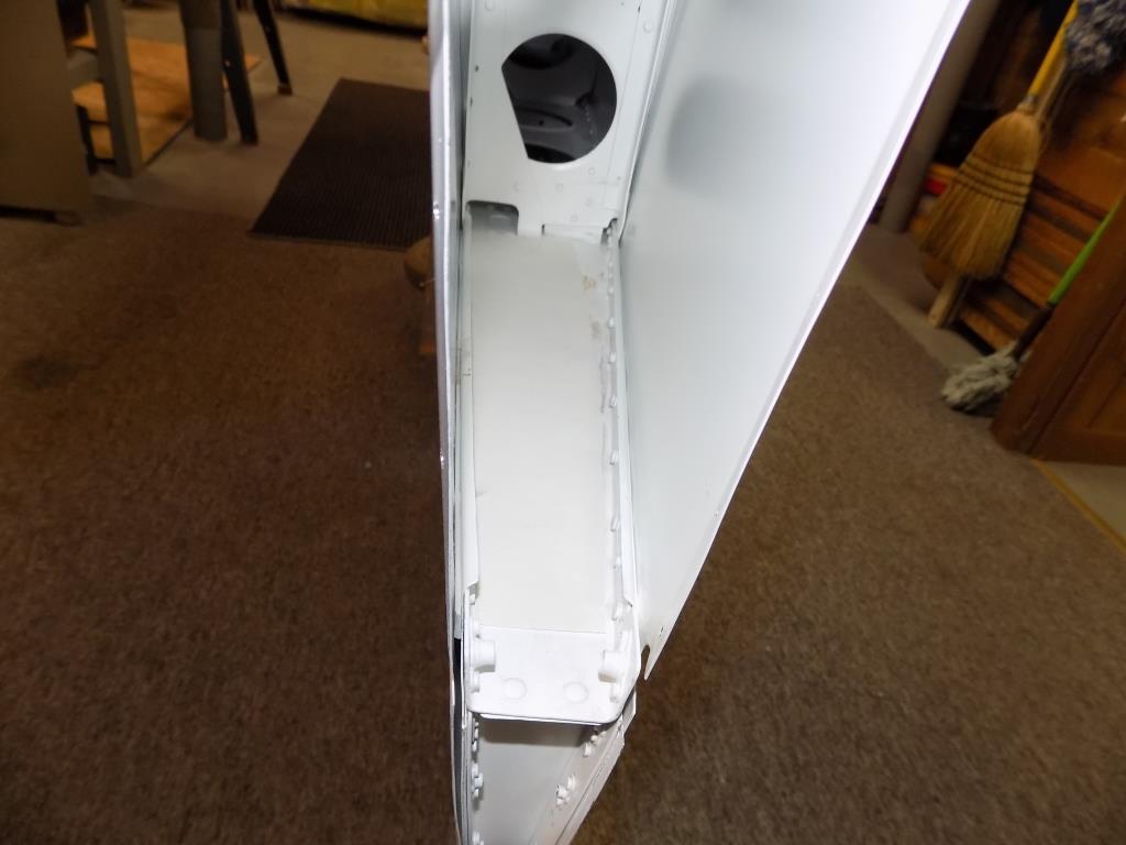

Re: Cost to Metalize

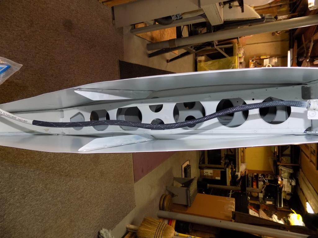

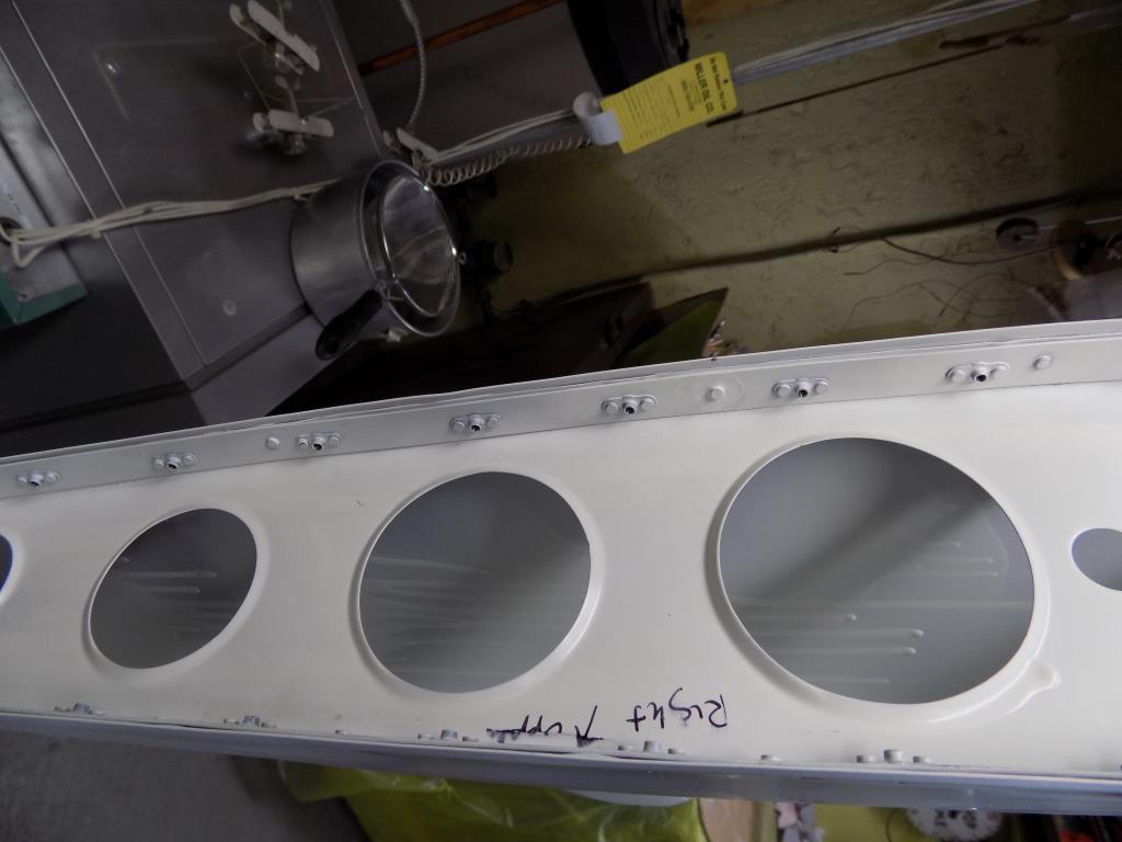

Fuel cell bay drain doubler inside view and leading edge landing light, which is another Skycraft STC
- S5005173.jpg (51.64 KiB) Viewed 6601 times
- DSCN0548.jpg (72.72 KiB) Viewed 6601 times

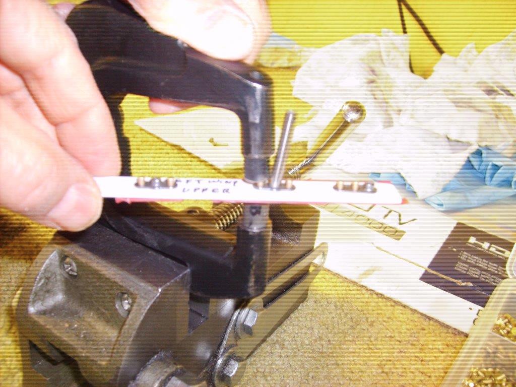

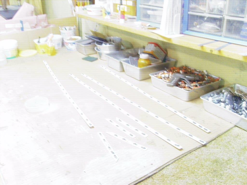

In lieu of blind riveting, I used #4-40 stainless steel truss head machine screws with nut plates onto an aluminum strip, which is in turn flush riveted to the inside of the wing tip. I had to partition up the nut plate strips to accommodate the tapered trailing edge. As you know, unlike later Cessnas, our wingtips fit inside the wing skins for the metal wing STC. Later Cessnas used screws for their wingtips.
The #4-40 truss head is not noticeably larger than a AN470AD-3 or AN470AD-4 rivet head from a short distance.
I also used #10-32 nut plates instead of nuts for the four standard #10-32 truss head screws that originally held the tip to the wing for fabric covering.
My approach is a bit heavier of course, but a removable tip allows access to wiring, etc. if needed.
See photos.
See photos.
- Wingtip hanging showing 4-40 nutplates.JPG (156 KiB) Viewed 6451 times
- Primed nutplate strips for tip.JPG (186.2 KiB) Viewed 6451 times
- Riveting nutplates onto alum strip for tip.JPG (192.38 KiB) Viewed 6451 times
ConsultEngr

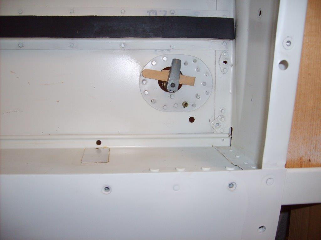

More photos
- Tip Fitcheck.JPG (124.45 KiB) Viewed 6451 times
- 10-32 nutplates tip.JPG (121.38 KiB) Viewed 6451 times
- Close up inside wingtip with 4-40 nutplates.JPG (121.48 KiB) Viewed 6451 times

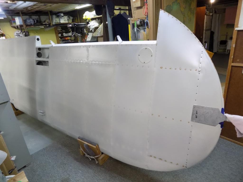

More photos.
- Wingtip installed with temp handle to move.JPG (130.27 KiB) Viewed 6451 times
- Wing End View before tip.JPG (162.82 KiB) Viewed 6451 times
