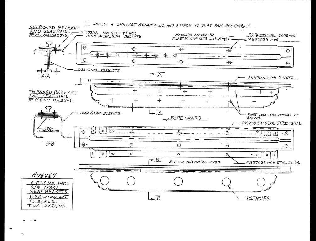

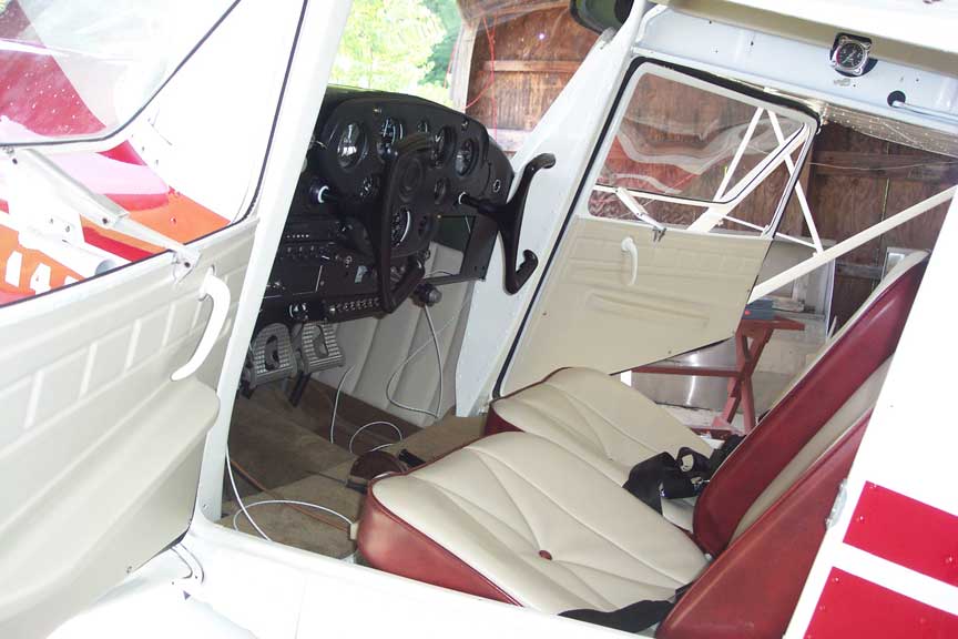

Attached is what I had in my files from the legacy C120/140 Association website circa 2006/2007 for C150 seat modifications to a C140.
There are three different form 337 backsides, and I've numbered them 1, 2, 3. There is a photo and sketch for the form 337 marked #1. The form 337s #2 and #3 have no sketches. A FSDO rejected the modification for form 337 #3 citing requirements for additional load testing/analysis and a maintenance with the wood block spacers.
Form 337 Backside #1.pdf
(182.01 KiB) Downloaded 980 times
C150 Seat Rails Sketch #1.jpg (106.91 KiB) Viewed 6541 times
C150 Pilot Seat Photo #1.jpg (52.81 KiB) Viewed 6541 times

I did not personally install C150 seat rails so I don't know the particulars, but looking at the sketch, the "M" part number is the McFarlane Aviation, Inc. prefix for FAA-PMA Approved parts that are suitable replacements for the original Cessna part numbers that for the C150 typically use the prefix "C". Generally I have found McFarlane's prices for other parts that I have purchased to to be lower than the list price for the same part from a Cessna dealer, which the McFarlane website usually shows the discount.
