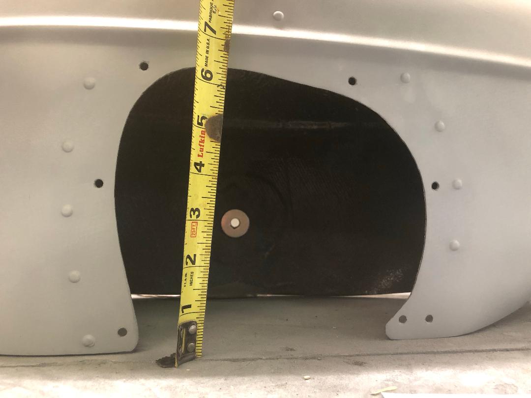

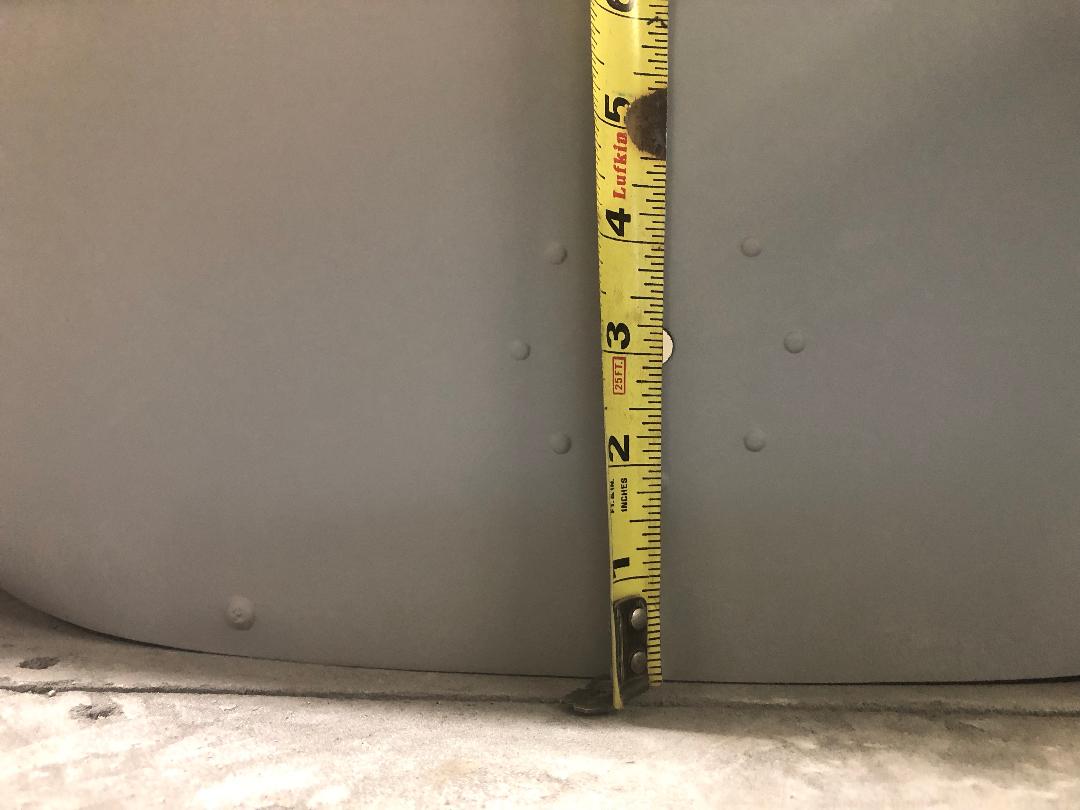

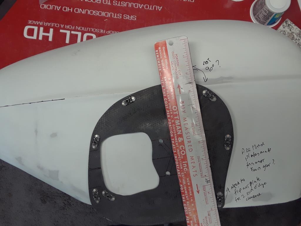

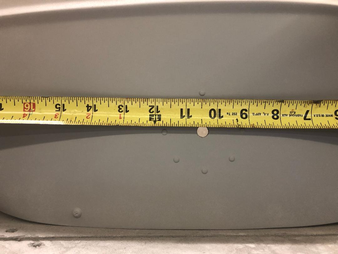

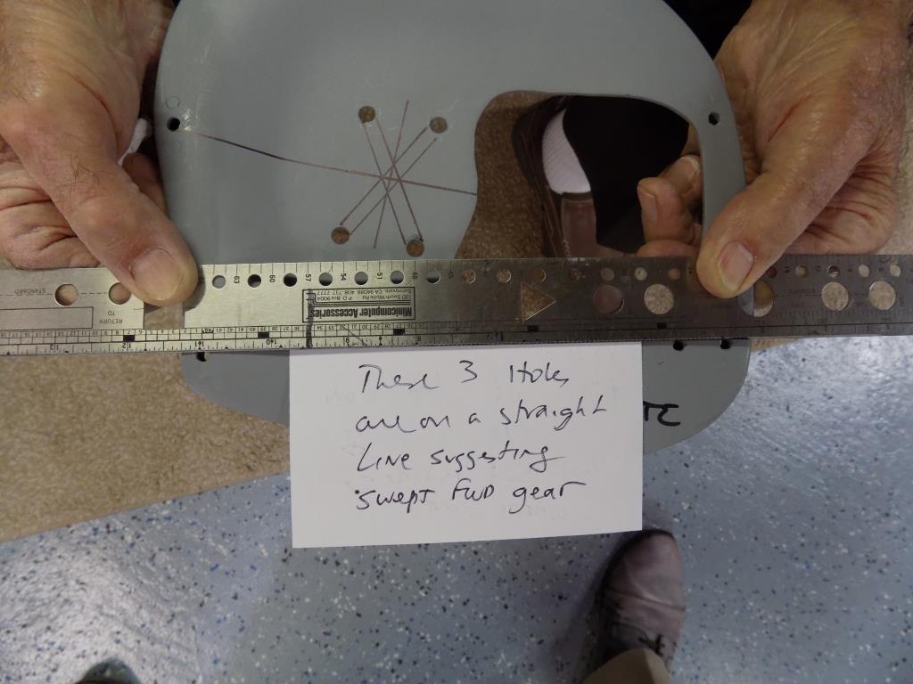

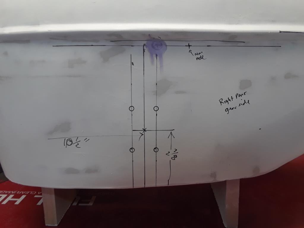

I ran into a small issue in trying to use the carbon mounting plates I purchased from one of the club members who made them for me a few years back. I think the 10-32 screw nutplate locations on the mounting plates are designed for the C140 swept forward gear configuration, but my project has straight gear legs. You can see this in the attached photos. I got some dimensions from the plate manufacturer on approximately where to locate the center of the axle on the wheel pant (it should be about 10.5 in from the pant leading edge and 3.13 in up from the bottom of the pant). This centers the wheel in the pant so there is adequate clearance on the front and back. I have confirmed these dimensions myself by blocking the wheel inside the pant. Also, one has to worry about the minimum edge clearances between the upper and lower nutplates. The upper nutplates need to stay below the longitudinal rib on the pant so the head of the machine screw clears it after mounting. On the bottom, per standard practice, there should be 2 diameters edge clearance (3/8 in for 10-32 screw). It looks like to make all this work, I have to drill out one of the rivets on the lower, forward nut plate so I can flip it around and redrill its center. This will allow me to rotate the mounting plate so the gear leg is perpendicular to the pant longitudinal rib. The pant should align with the streamlines in level flight.
In my situation, it looks like I will need to locate the axle center 2.88 in up from the bottom of the pant vs. 3.13 in up. This means the wheel will stick out of the pant a bit more, but there still should be adequate clearance of the wheel between the front and back of the pant. Once I locate the axle center on the pant, then I am set to cut out the inside of each pant to clear the landing gear and brakes.
I set the photos up for the right wheel pant, but the plate is on the wrong side just for illustration purposes to show the issue. It is easier to show the issue from the outside of the pant vs. the inside.
I am contacting the builder of the mounting plates to confirm my analysis.
- Plate Pattern for Straight Geatr.jpg (42.6 KiB) Viewed 7263 times

Re: Wheel Pant Alignment and Cutout
More photos
- Wheel Pant & Plate Appears to be Swept fwd gear.jpg (75.91 KiB) Viewed 7263 times
Plate has the bottom three holes in line
- Plate hole line.JPG (142.87 KiB) Viewed 7263 times

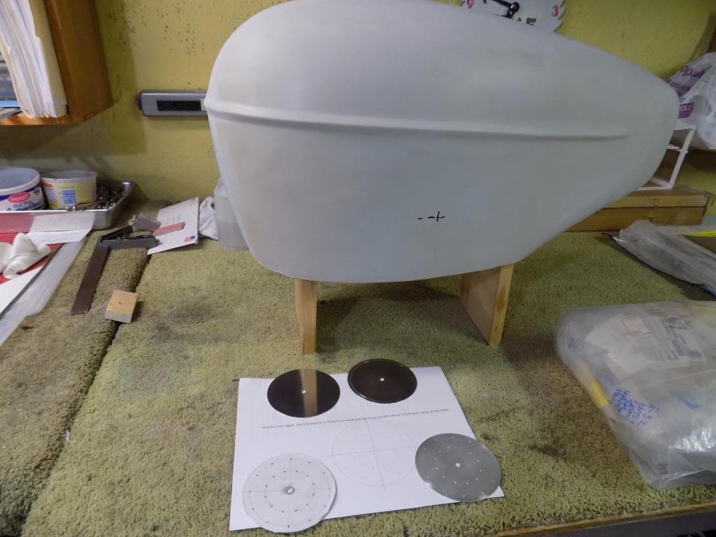

These photos are what I got for setting up the location of the plates. These are not my pants because I have not made the cutouts yet, but you can see that the bottom #10-32 holes are located in a line the same distance from the edge, which as my prior photos show, would but the landing gear at at an angle to the wheel pants. This is why I concluded that the #10-32 nut plate pattern on the plates I got are set up for the swept forward gear.
Not a problem though as I plan to drill out a rivet in the forward nutplate so I can rotate the nutplate 180 degrees. This will allow me to get the mounting plate set up so the pant is perpendicular to the centerline of the straight gear leg.
