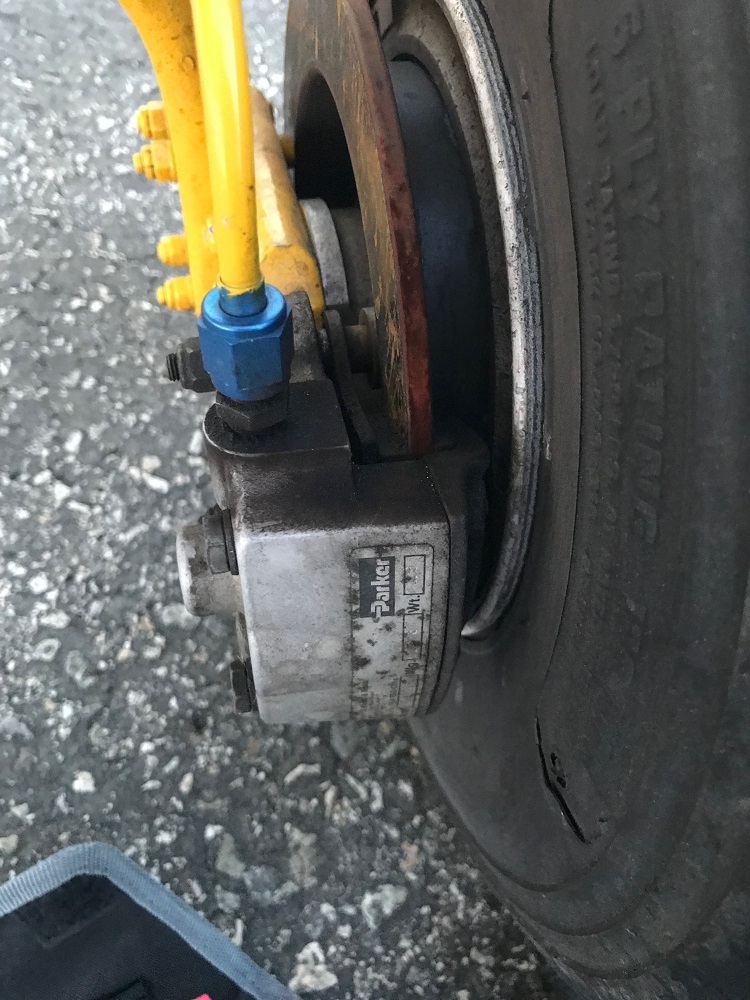

The hose in the photo looks like an automotive part. Be aware that automotive flares are not at the same angle as aircraft (45 degrees vs. 37 degrees.)

Can someone help me source the right fittings/line to use for this? From browsing aircraft spruce it looks like using the Nylo-Seal line is a good option. I just need the fittings that screw into the top of the caliper, then whatever I would use to butt the nylo-seal and hard line together.

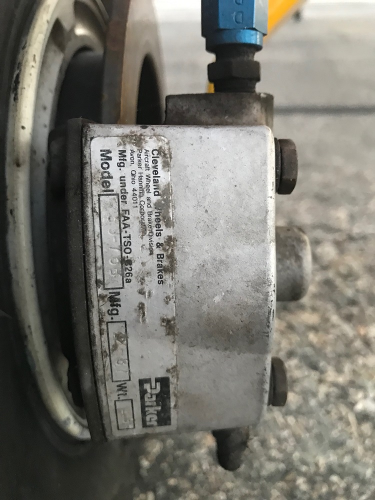

I want to verify my parts list. The part number on my brakes is pretty faded, it's hard to read (photo attached). From what I can tell the part number appears to be 3X-75B. The closest match in the Cleveland/Parker Parts Catalog is 30-75B. On page 4-16 (pg102) it visually looks like my brake caliper. The elbow I'm looking for is item #15 is listed as MS20822-4D. When I search that on ACS, it tells me that the thread is 1/8" thread (link).
Moving onto the Aeroquip 303/491 hose/fittings. The -3 is listed as for 3/16" tubing and the -4 is listed as for 1/4" tubing. When I look at the 491 fittings, -3 lists 3/8-24 thread and -4 lists 7/16-20 thread, neither of which are 1/8" thread like the MS20822-4D elbow. Do I order either one and just get an adapter? Are they not referring to the same thread? The datasheet from Eaton doesn't list any more details about the 303/491.

[Edit] I'm guessing you were planning to have the hose run horizontally as in the photo posted earlier. I would cut the hard line on the vertical section and install the hose with a 45 degree bend to the caliper so the caliper floating is flexing the hose along the bend instead of lengthwise. (I don't think I explained that well. Look at AC43.13-1b Chapter 9.)
John as always thanks for the details. Making my life a lot easier, and I'm learning along the way.
My plan was to cut on the vertical under the step on the gear leg, then route down to the caliper on the under side of the gear leg.
I believe I understand what you're trying to say. Are you saying put a 90 elbow on the caliper and a 45 elbow on the vertical/hard line? Or a straight out on the vertical and the 45 on the caliper? The line will be 12-15 inches, so I don't think there will end up being excessive bend radii (per chapter 9 of AC43.13).

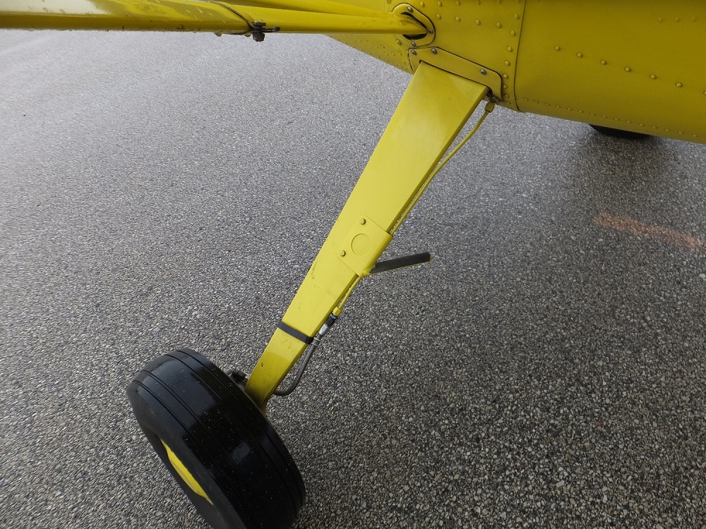

Posts: 743
Location: Michigan
Re: Removing Wheel Extenders
Post by V529 »
I believe that this is about what John is trying to describe. I found a yellow airplane so it would be as close as possible to what you have. ;)
