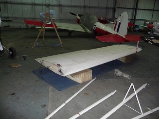

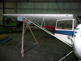

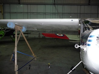

Not sure if these help?
- wing 3.jpg (45.18 KiB) Viewed 6705 times
- wing 2.jpg (42.69 KiB) Viewed 6705 times
- wing 1.jpg (44.59 KiB) Viewed 6705 times
