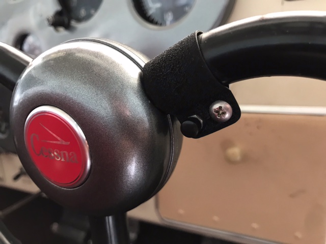

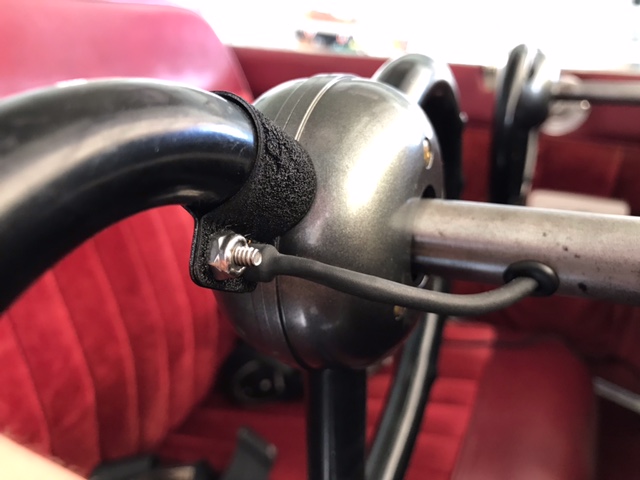

I just made a little loop out of aluminum and ran the wire through the yoke. A little heat shrink and some rubber grommets added a nice touch.
