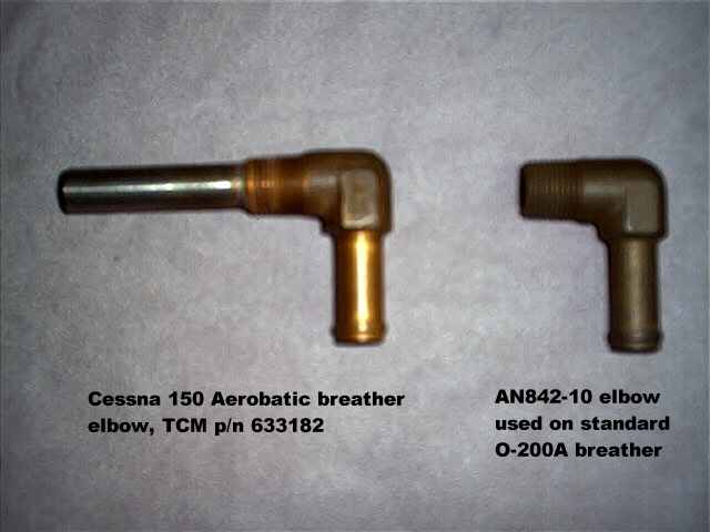

First, I’d like to find a 633182 breather elbow if anyone has one laying around that they’d sell.
Second, my breather has the original routing (not over the top) but it outputs directly into the cowling; if I remember right its output sits about 4-6” above the bottom of the cowling. I think it should output just below the bottom of the cowling with an angled cut which faces forward.

Posts: 2843
Re: Engine Breather Tube Routing
elliotblock wrote: ↑Wed May 13, 2020 9:57 am First, I’d like to find a 633182 breather elbow if anyone has one laying around that they’d sell.
Make one.
extended breather.jpg (21.58 KiB) Viewed 6904 times

a64pilot
Posts: 319
Post by a64pilot »
6643 wrote: ↑Tue May 19, 2020 8:25 am
Make one.
What did you use for tubing, it looks like SS? Did you machine out the fitting? Silver solder or tig or what?

Post by 8342 »
Neal Wrights technical article in this forum tells how to make the breather elbow.
Post by 2356 »
I silver soldered a piece of brass tubing in mine.
Post by 7392 »
To 2356
Re: BREATHER TUBE ELBOW
I also intend to silver solder a piece of brass tubing into my current breather tube
this weekend. What length of tubing worked for you? My mechanic said he couldn't locate the
Neal Wright article.

a64pilot
Posts: 319
Post by a64pilot »
I’ve not read the article lately, but if memory serves it doesn’t specify a tube diameter internal or external, does I believe mention machining out the fitting, but doesn’t give specifications. It gives I think a length of 2 3/4” again going off of memory and I assume that is a length that extends from the fitting and not a total length? So we need maybe a tube 1/2’ or so longer?
Now I know that it’s possible to have too small an internal diameter and that restrict airflow and raise crankcase pressures more than desirable, so I was wanting if possible a tubing recommendation. Thin walled tubing would I assume be best as that would give you the largest internal diameter without having to machine out too much meat on the fitting. ButI done know what the internal diameter of the factory part is, that might be useful information.
