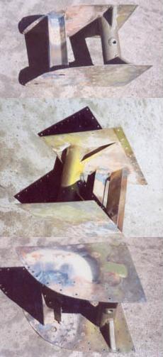

Can the 140 gear boxes be welded or have they been heat treated?
They will be coming out in the next few days and just trying to determine if they can be repaired or if they need to be replaced.
Thanks,
Jimmy
Thanks,
Jimmy
- Posts: 728
Re: Landing gear boxes
As best as I can see from the reference info, just weld them up and re-install.
- Posts: 567
Tig weld, rosebud to heat/stress relieve, sandblast, zinc chromate. I recall only one rivet hole was out of alignment when we put it all back together.

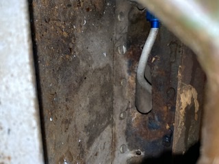

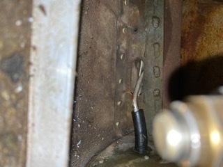

Attached are the cracks that I have where the brake line comes through the box on each side of the plane. Any thought as to if it needs to be repaired or can be monitored.
- 00EB21A8-C26D-4CE6-82AA-11EE8B5A0394.jpeg (25.52 KiB) Viewed 7652 times
- 21EDF275-F9EA-45F1-9346-D4D8D27E3F47.jpeg (29.04 KiB) Viewed 7652 times
- Posts: 600
- Name: Mac Forbes
- Location: North Carolina
James K. wrote: "...needs to be repaired or can be monitored...".(?)
FWIW, I'm aware of a couple that have been monitored for several years after having been discovered (...really hard to see, as you know). On both aircraft (120 & a 140), there's been absolutely no change over the years and hours. Those small "panels" ("Angle - Support"...maybe .025 stamping?) were added on later SNs (14163>), but were apparently(?) not "needed" in earlier years, and for some reason they seem prone to flexing and cracking until they "settle down"(?) on some aircraft. IAs involved with these two were comfortable with monitoring. Again, FWIW -- with your floor removed you're getting pretty close to them, so a "repair" may make sense if now accessible. It's hard to see from pic, but one does appear to be a bit corroded, also(?). Mac
