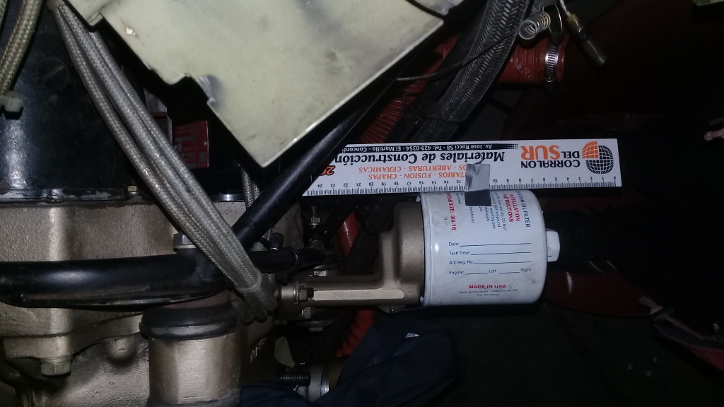

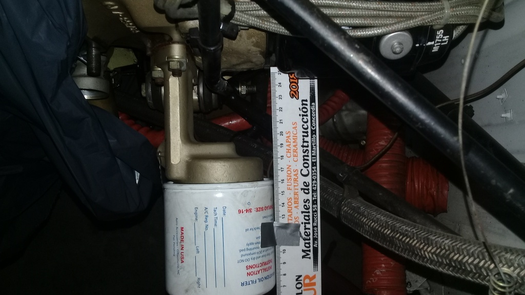

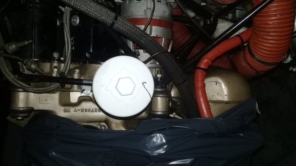

Hello Graham,
First of all, thanks to all members for their contributions.
I went this morning to the airfield and photographed our C150, that is in top overhaul process. So it was very easy !
I attach four pics of the filter from different positions. No curved pieces in the original C150 to O200 engine mount.
Hope this can help !
Sorry, system does not allow me to include 4 pics, I will place fourth in a separate answer.
Kind regards
Horacio

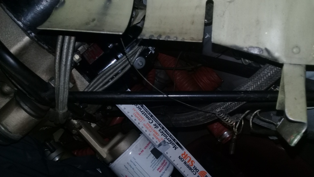

Fourth pic.
C150 engine mount with TAF L filter adapter.
Horacio
Horacio

Thank you Horacio and Larry for your addition to the discussion, debate is always worthwhile.
I will make a template of the TAF-L, using a friend's C-85 C120 as reference, this weekend, and see whether it will indeed, fit, as member #6643's message in page 1 confirms it should fit with a crane with the curved section.
I certainly hope so.
I would welcome a picture of the unit fitted on an engine using the frame with the curved section.
Graham
Graham

I have spent the afternoon measuring and comparing between my 120 O-200 (engine mount with extra curved section) and a friend's 120 with C-85 (with no curved section) and there is NO WAY the TAF-L is able to fit, without some adaptaion !
I can think that a spacer between the engine and the face of the TAF-L mount and using thin nuts, to allow sufficient thread clearance, it could possibly allow it to clear the curved section, or replacing the mounting studs with longer ones (which I am not keen on doing !), but 'out of the box' it will definitely not work.
I would welcome any thoughts from those who have similar engine/engine mount ...
thanks
Graham
thanks
Graham

Hello Graham,
Just one more idea: the special engine mount in your plane, I suppose must have an STC owner that developed it.
Am I right ?
Perhaps that person has a key information about your case.
Our adapters are in the market since long time, he should be aware of the existence of our kind of adapters, unless the engine mount is too old.
Good luck !
Horacio
Am I right ?
Good luck !
Horacio

I believe the mount in question is the 140A mount, and not a third party mount.
The -L version of the filter adapter was developed for exactly the reason noted: to clear engine mount structure. (In fact, I think it is the only variant currently in production. Without the mount, engine and adapter in the same place at the same time, I guess we can't know for certain. I have an adapter in the hangar and I could make a template from it if that would help.
Also, don't overlook this post:
Randy and I will never agree on the filter issue, but we both agree that frequent oil changes are good for the life of the engine.

On the other hand, if it's a tight fit, don't forget that the engine, and the oil filter adapter, if installed, will move around a little whereas the mount won't move with it...
