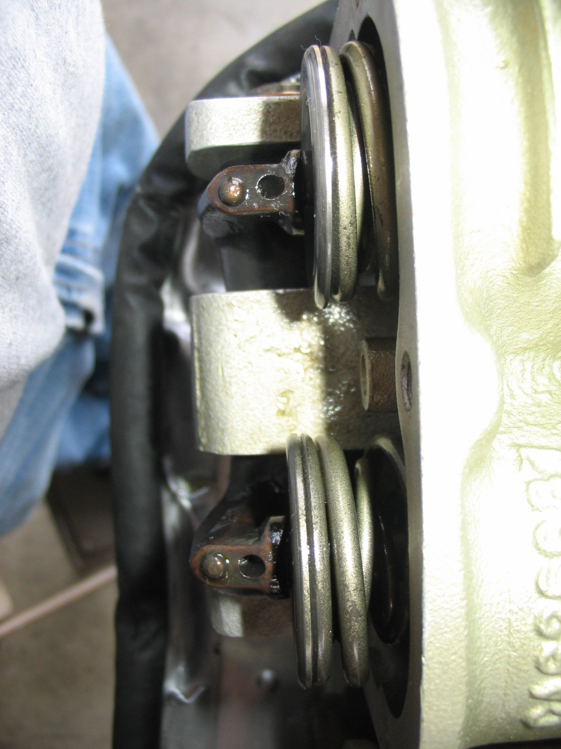

Re: REAL Push Rod Tube STC
Well now that explains a few things on my bird......
- 6-16-09 006.jpg (192.25 KiB) Viewed 3670 times
I was about to send my rocker arms in to Aicraft Specialties and noticed I have the same issue. All the rocker arms are drilled. At around $500 each, it's too bad the hole can't just be plugged.
