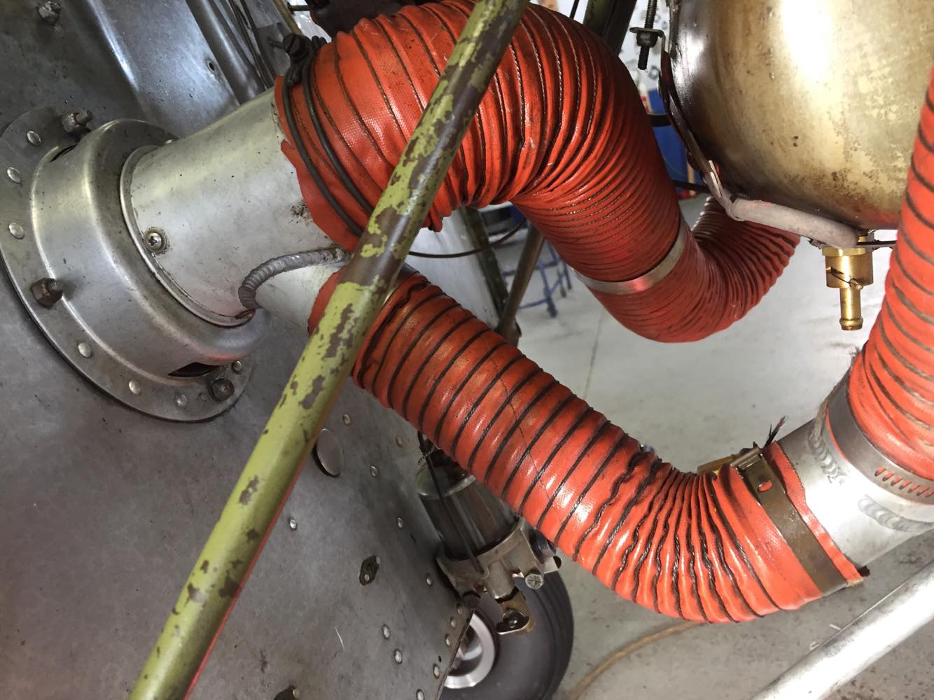

5806 wrote: Wed Oct 16, 2019 9:53 am
8322 wrote: Tue Oct 01, 2019 10:18 am Not sure how it works, if theirs covers this or not, but when mine was done in 1980 they used the 150 setup that pulls heat off both sides... I know our gals have a reputation for low heat output... Mine with that set-up will cook you out...
Hello Raymond,
Curious if the carb heat is shared with cabin heat on one side?
John, I will have to look to refresh myself on how it goes. Its going in for annual in the next week or two, so I'll see if I can get come cowl off pics
Ray

Here is how my setup was done, I have plenty of heat!
Hope this can help someone else doing this...
