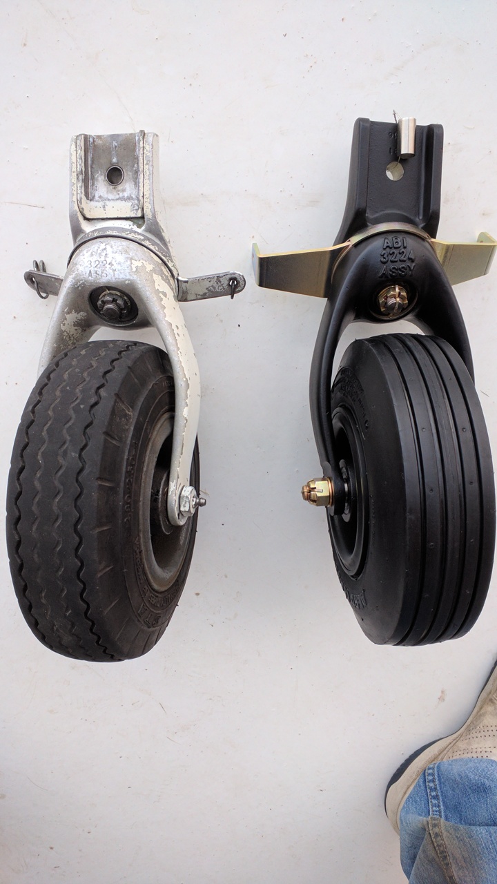

When it was Scott, that steering arm was on some of the 3450 series heavy duty wheels. They were used on things like the Cessna 185. I know some folks put them on the 3200 series assemblies. Not sure that was completely Kosher...
What does ABW call that assembly?

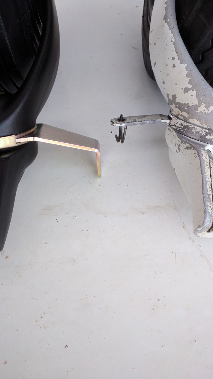

The "bent" steering arm part number is ABI-3214-00.
I have attached a couple of comparison pictures.

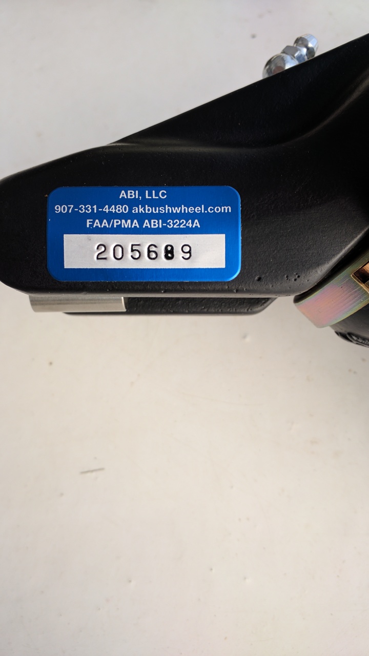

Can you post a photo of the data plate?

Sure, here you go!

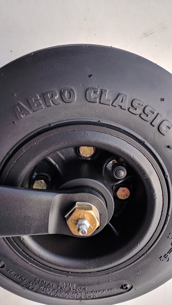

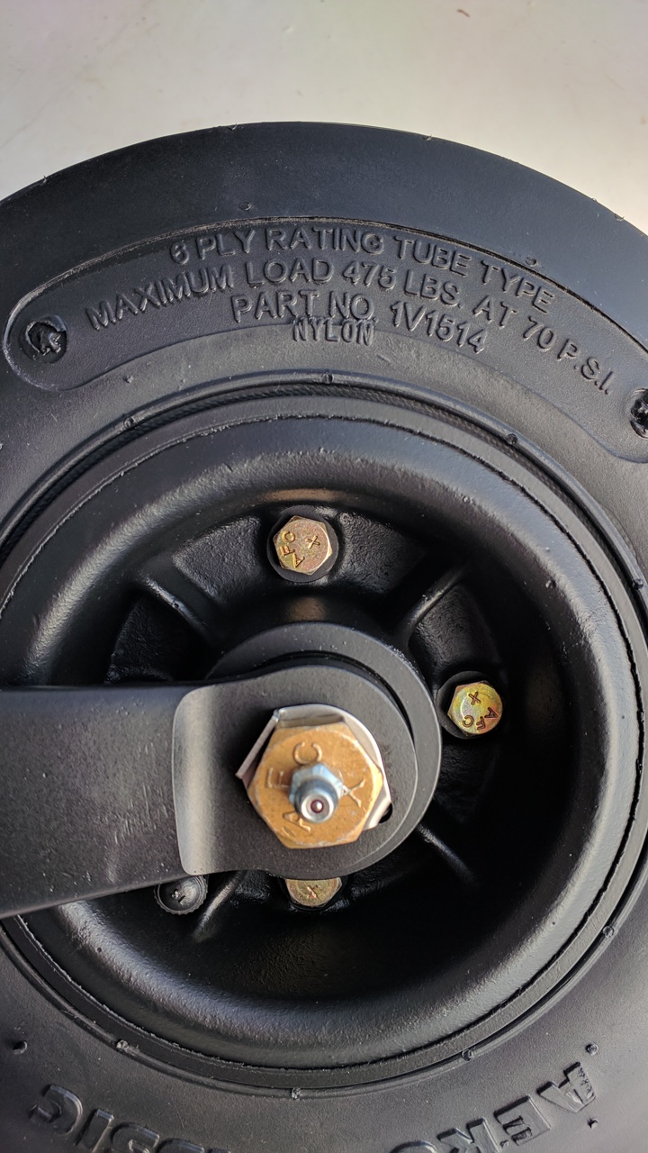

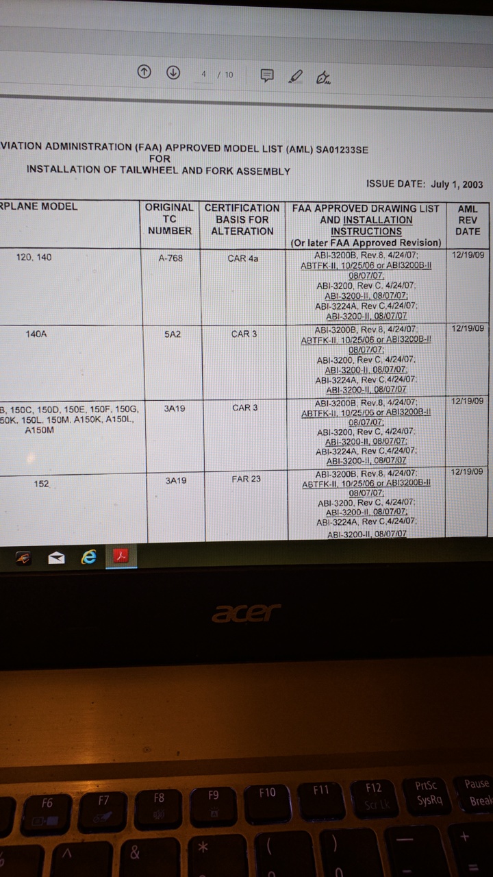

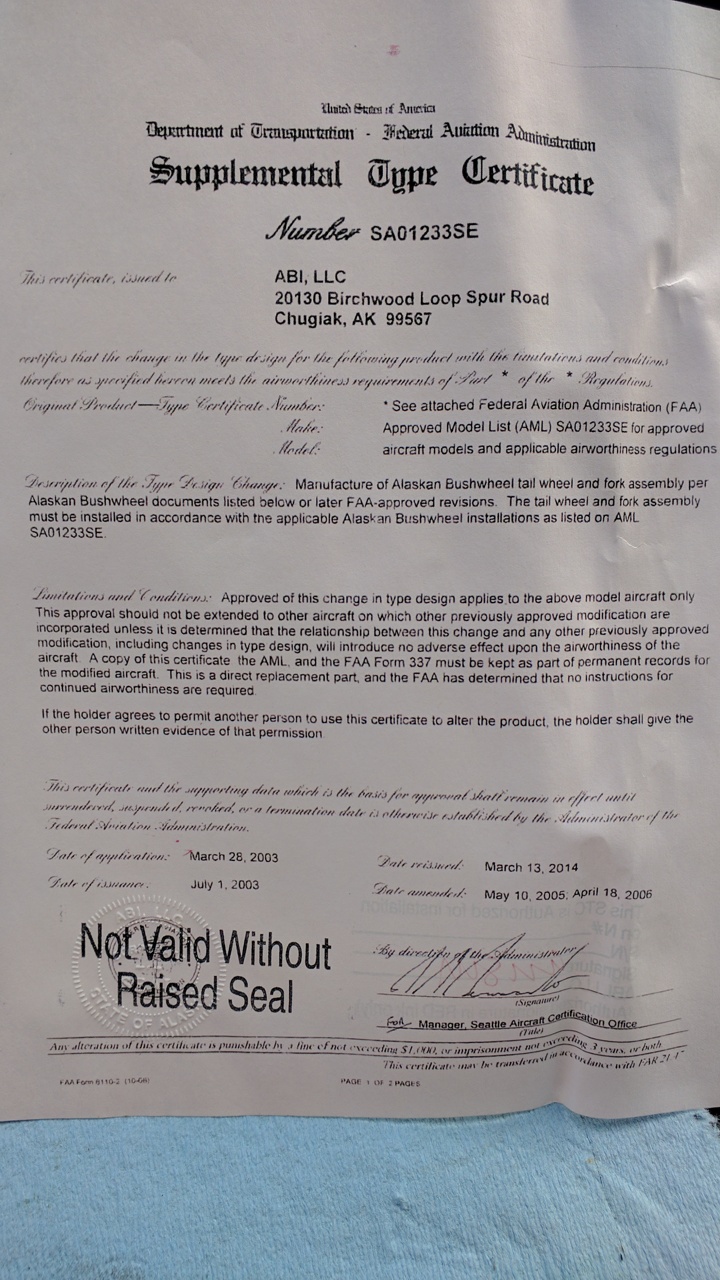

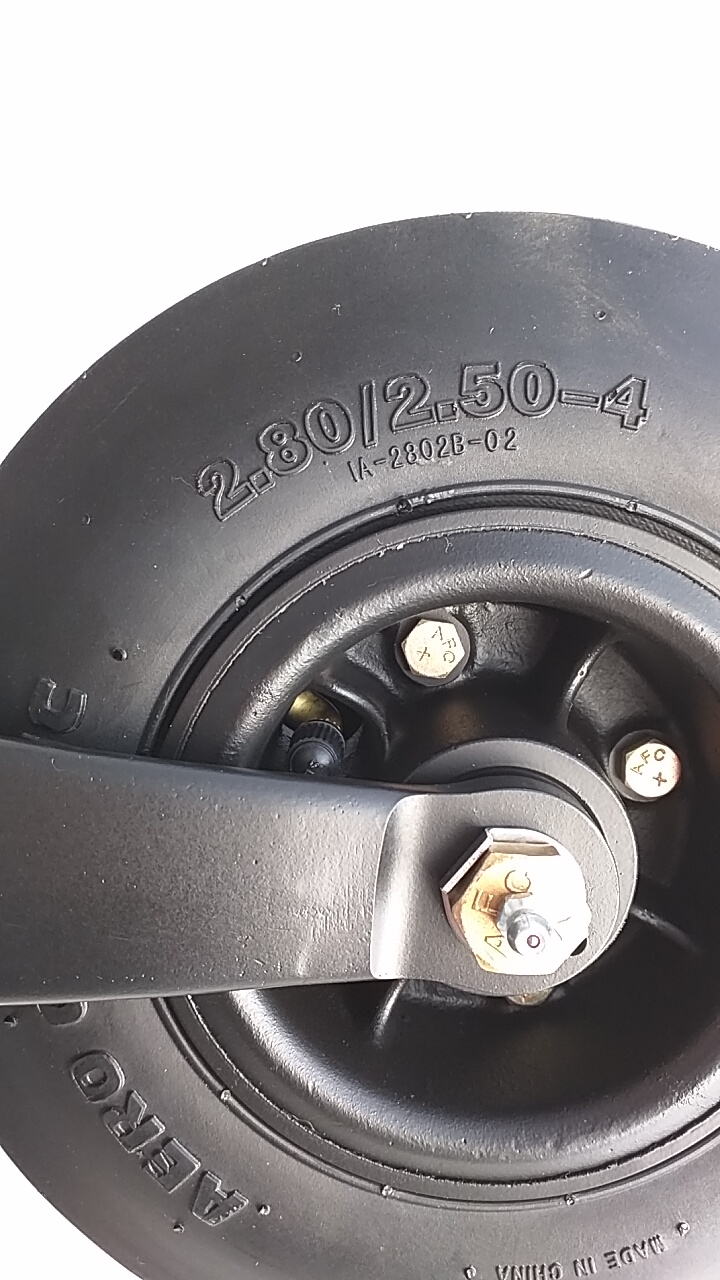

Took a couple pictures of the tire that is included in the assembly, and hopefully you'll be able to read the STC document.

A couple of the pics did not attach to the previous post. Here they are.
