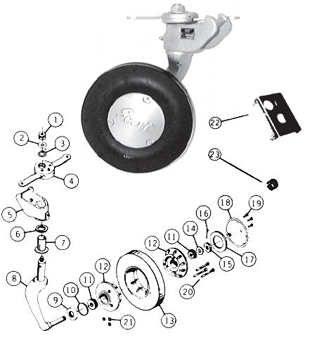

How do you like the maule tw? It is a cheaper alternative then the 3200 but we had one on the cub and could not get it to stop with the shimmy.
8359
- Posts: 236
- Name: Tamer A
- Location: KDVO
Re: New Owner
I've heard nothing but bad things about the maule, but I haven't had any issues with mine. I was tempted to "upgrade" to the 3200, but since it's working well for me I don't want to "break it"
When it comes time to replace it I'll look into the 3200.

Thanks, i suppose ill just invest into the 3200
- Posts: 569
Re: New Owner
Andrew,
In case you were looking for info about servicing your 2000 tailwheel.....
viewtopic.php?f=10&t=147
viewtopic.php?f=10&t=134
https://www.aircraftspruce.com/catalog/ ... kkey=22510
- AirAssociatesCatalog.pdf
- (330.72 KiB) Downloaded 1061 times
- scottModel2000.gif (42.09 KiB) Viewed 6470 times
