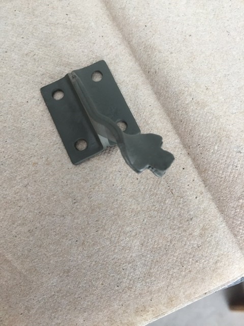

Is this something you can use? I’m thinking it may be for the right side, but if you can use it, it’s yours.

Re: 140A Door stop
Hi,
I really appreciate the offer but that is different than mine. I was at my hangar all day yesterday working on the plane and didn't think to take a picture. I will go back in a couple days so I can post what it looks like. With all the pictures I have seen of the different ones it sure looks like Cessna made a one off for the A model.

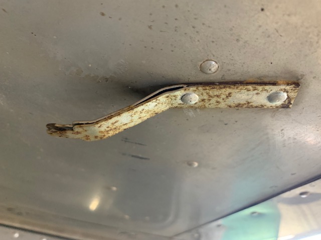

Re: 140A Door stop
Was back out today and remembered to take a picture. It's made from 2 pieces of thin mild steel, I didn't have anything that thin so just for the fun of it I made one up from .032 aluminum. I think that would work, but will look for some steel. I haven't made up a wooden drill stop yet as John suggested, but I think using that I would be able to carefully drill those rivets out.
