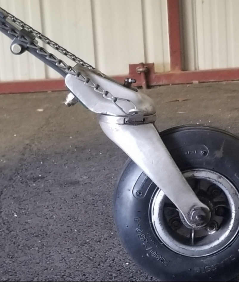

Re: Scott 3200 high speed shimmy
Neal's article mentions that sometimes you need to use what works, even if by serial number it may not be correct.
Here's a picture of my tailwheel geometry with a double bend spring. It has a good caster angle and I am not getting any more shimmy!
