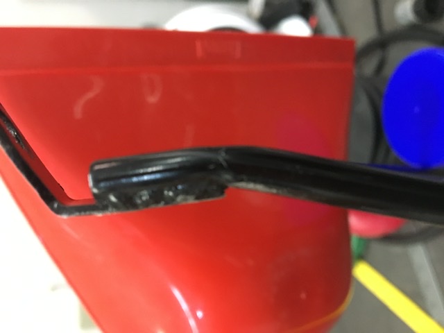

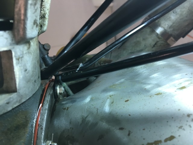

Just as an update, I have the Wag Aero bracket installed.
You will have to bend it to clear the right side engine mount, but it’s an easy bend.
If you look you can see how the bend gives clearance, there is maybe one thread showing on the stud, no washer was used.
Mine doesn’t fit really well, and I’d assume there is enough difference between sets of pies so that it never will.
If I still had my welder, even a buzz box it would have been easy to cut and reweld for a perfect fit.
Re: More exhaust questions
"...cut and reweld for a perfect fit".
Yep, I've had to do that a few times over the years (...changed pipes a few times in 36 years owning -- they're never the same distance apart). Anything you can do to have a firm fit, but without being "sprung" will help prevent cracking. your installation looks good!! RE the stud, I have had that one break, right at the drilled hole, and I replaced it with an undrilled that's a bit longer. Mac
