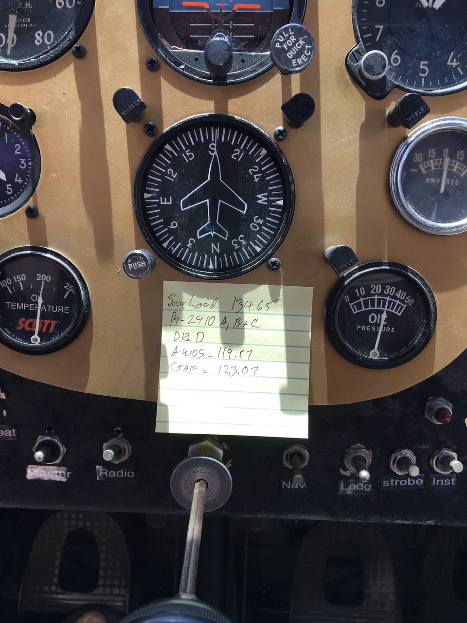

Re: High oil temp
Todays lunch flight, OAT was 94F
- 8085C2D6-78B2-4453-8BAE-59081DB2F1AF.jpeg (368.14 KiB) Viewed 5810 times

So my oil pressure was also running on the bottom end of the range. With Oil Temp at 190 or so it took full cruise RPM to just keep it at 30 psi. I changed out the spring as mentioned here. The new spring is shorter than the old spring, just like here.
Today I had 52 psi on takeoff and 40 psi in cruise with 180 degree oil temps. Apparently the old spring wasn't holding tight.
