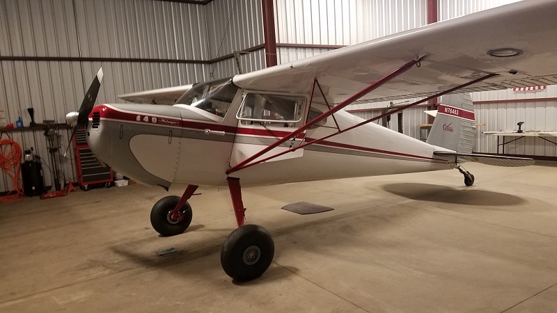

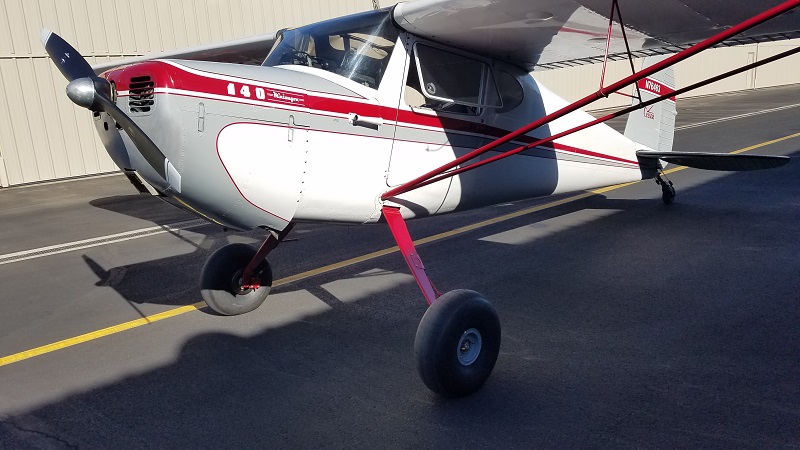

I finally got them installed and flew it for the first time last week. I must say its a lot softer landing feel and I love how it looks
- 8.50-2.jpg (140.27 KiB) Viewed 12176 times
- 8.50-1.jpg (126.23 KiB) Viewed 12176 times

Oh, man. Want.
