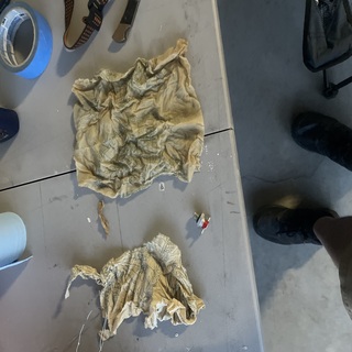

Unfortunately, all the work I did didn’t solve the problem. Again, I had power loss on the right tank. It was more severe than previously. I was descending at about 100 fpm at full throttle. Power was restored once I switched to the left tank. After landing I did a drain test as before and it took 2.5 minutes to drain a gallon from the right and 1.2 to drain a gallon from the left. There was 7 gallons in each tank? I drained the remaining fuel from the right tank, and used a flashlight and dental mirror to inspect the tank. I found a large piece of cloth near the finger strainer and removed it. I looked for some more and found a larger piece lodged in the inboard rear section of the tank. Took some effort to remove it as it was almost glued in. Maybe some kind of sealant or old fuel residue. Hard to tell. I plane to drain and check the other tank just to be sure.
I would encourage everyone to borescope their tanks and verify you don’t have some debris in lurking there waiting for the right moment to make yor plane a glider.

After removing the debri, I went back in with a borescope and found even more of the same material. Including another large piece about 6x8”. I can see lots of tiny bits all around , so I plan to flush the tank tomorrow

Any idea what it is was?

I see from your other thread that you've identified it as an old dish towel. Interesting, to say the least...
