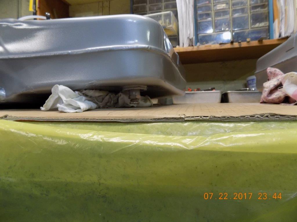

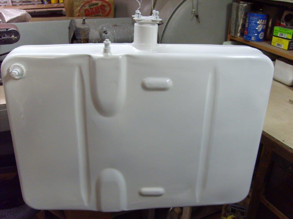

Here are the photos that I referenced in my prior post to show that the bottoms of my left and right fuel cells are equivalent and neither is "pushed in" to change depth of where the fuel drain valve sits with respect to the lower wing skin (inside or outside).
- R Fuel.jpg (78.54 KiB) Viewed 2790 times
- L Fuel Cell.jpg (59.94 KiB) Viewed 2790 times
