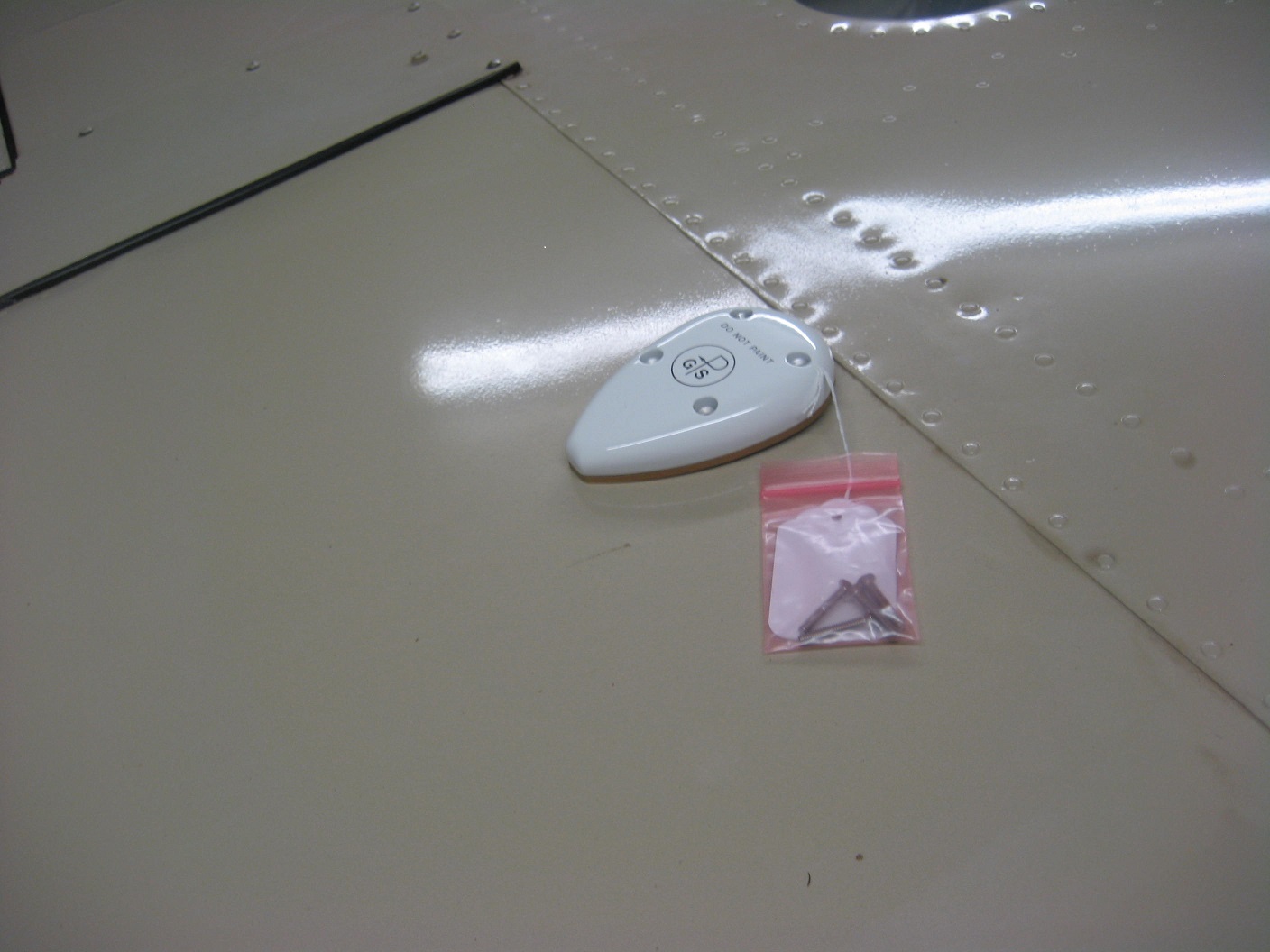

8233 wrote: ↑Sat May 26, 2018 3:57 am Is there a consensus on the best place to install the GPS antenna? Most practical, easy to get to, etc,,
...not sure it's the best, but mine fits well exactly where my old Loran C antenna was, near/rear of the spar carry-through. That spot keeps it the recommended distance from both the comm and elt antennas & is relatively easy to access (& no need to drill another large hole)
. Mac

Thank Mac, that's very helpful and I think makes great sense. Since I have never had more than a Comm and ELT antennas (I have 2 com antennas on top), I'll need to drill a hole but that looks as good as any. Especially if it's easy to get to. My plan is to go with the Stratus ESGi setup by the way.

I hear you there. We already have our Super Viking ADS-B Compliant but we went with Avidyne since we also had a 430 WAAS installed. For in, we have been using a Stratus 2S and I have been very happy with the unit. The closest option I found in price was a GTX-345 that had both out and in. It was over 2k more. It had other features to tie in to Garmin gear and compatibility with Garmin Pilot. Don't need any of that so I agree the Stratus ESG seems to be the best option.
On your antenna picture, did you install a doubler to beef up the mounting point? My IA says he thinks he will need to put one in when they install mine if I use the same antenna location as your pic.
David Freeland - CFII
Re: ADSB
RE: Antenna doubler -- yes. The previous IA didn't require one when we installed the Loran C antenna in that position a "few" years back, but since the ADS-B install manual calls for one we'll back up the GPS antenna with one (...would probably have to placard "speed limited to 300 kts unless antenna doubler installed" if we didn't? ;-)). Mac
