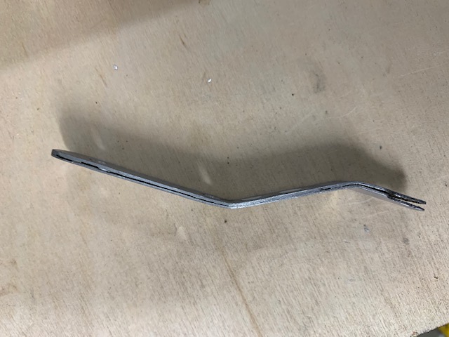

Yes, I agree. Just quickly fabed it up to see what it looked like, here is the quick and dirty version. I used a rivet to hold it together so I think I could do the same with steel. I'm going to make up a wood stop and drill those heads off, thanks for that tip.

Drilled it out today using John's redneck drill stop, no issues, came out clean. Still working on fabricating a new one, bought some 16 gage sheet and riveting it together worked fine but that gage was too heavy, I will try and make one up with 22 gage to see how it goes.

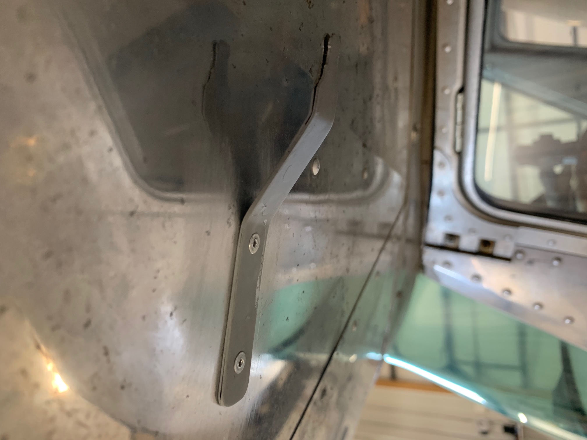

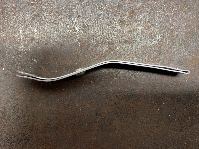

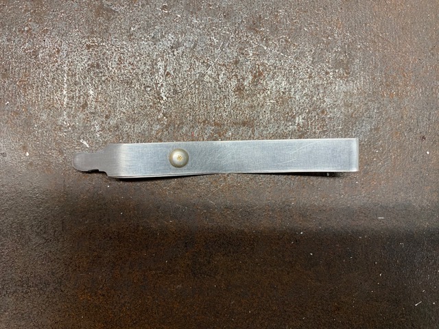

Finally got around to making that stop today. Used 22 gage sheet steel and that worked out just right. Went on with no issues and works as good as the factory version.

Re: 140A Door stop
Post by 6183 »
Looks great!

Re: 140A Door stop
Post by 8474 »
Thanks Mike, I'm just happy that it holds the door open now :D
Re: 140A Door stop
Yep -- well "researched", well "designed" to match/function & very well "manufactured". Good job, Blaine -- thanks for sharing the entire process!
