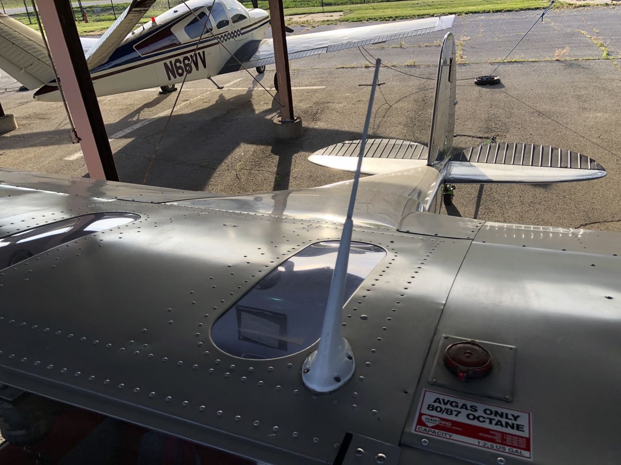

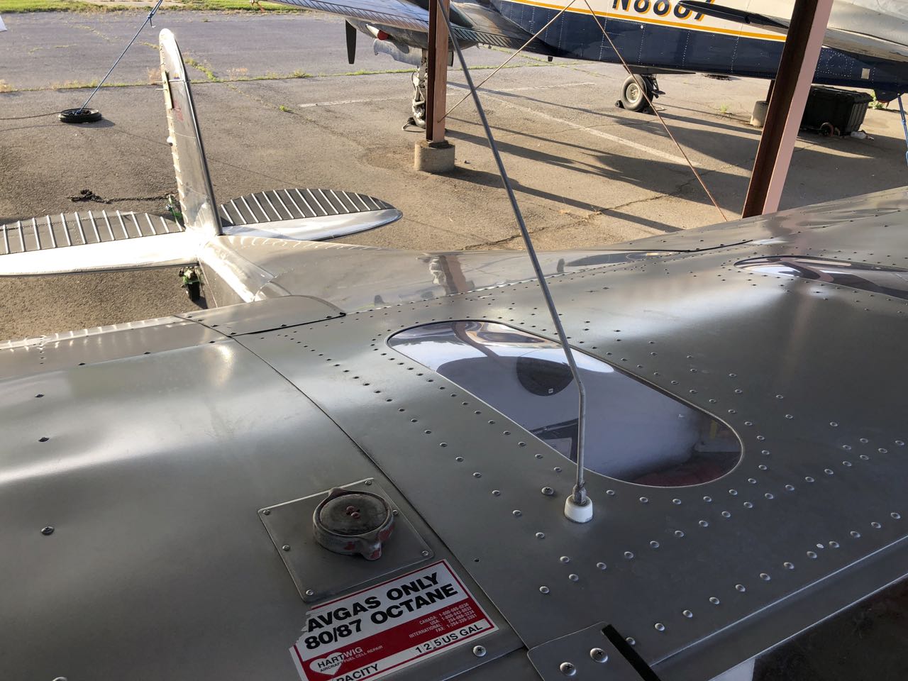

I only have a single com but have 2 antennas installed with one antenna not in use. I was thinking of using the old one for the GPS antenna. Would this cause any issues? Pics attached. I would be replacing the bare wire antenna and using the hole for the GPS.
Thanks!
Thanks!
- IMG_0415.jpg (171.31 KiB) Viewed 10033 times
- IMG_0416.jpg (174.74 KiB) Viewed 10033 times

...sorry I can't answer the question re GPS antenna placement where the current antenna is located, David -- that's one of those questions I'd pose to the Garmin tech (or, a tech for whatever brand of GPS/antenna one might be installing). If there's no possibility of interference with the other antenna & if it'll fit there with a proper backing plate it sure appears to be a good spot (...and, good re-use of a pre-existing hole!).

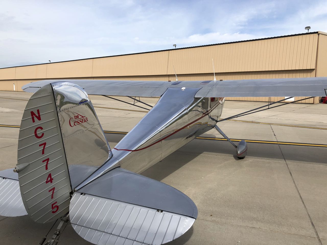

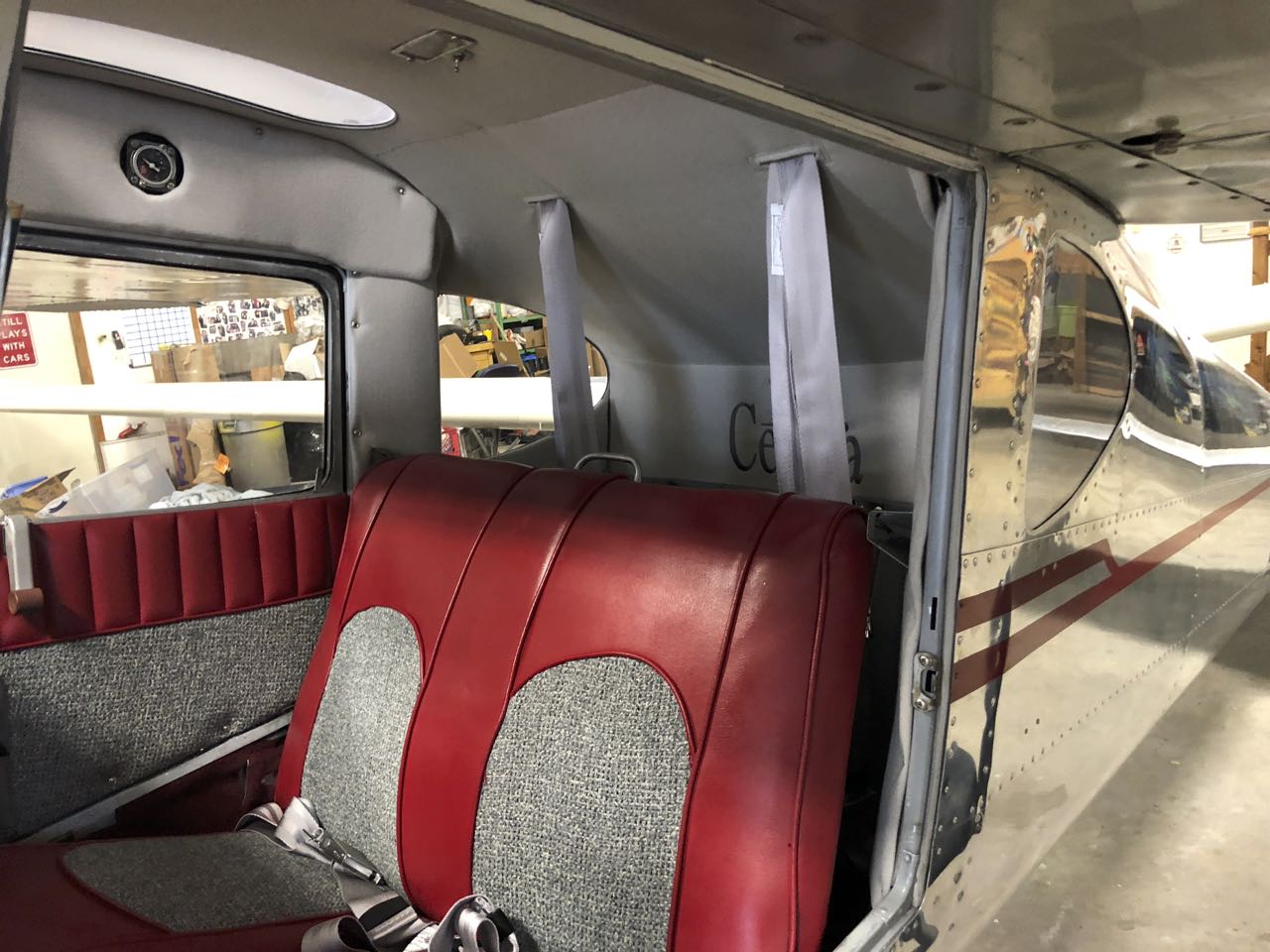

My ADS-B is also all complete using the Stratus ESGi and Trans-Cal encoder to replace my Narco 150 and AR-300. I picked it up in Joplin, MO and made my way to Poplar Grove and watched Ken & Lorraine work their magic adding D windows, new hooker harnesses, new headliner, baggage compartment, new window latches, door pockets and replaced the cardboard backing with sheet metal.
I was totally amazed at the speed and quality they showed. It was a tremendous honor to spend time with them and a whole lot of fun. I learned a lot about my airplane while I was there.
Here is a before and after and also an exterior shot to show where I put my GPS antenna.
