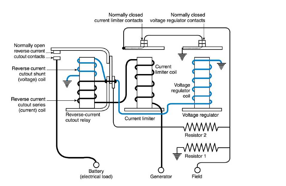

Note John C diagram - V and I reg points closed until engine running, air gap is for operating state.
Any fuses blown?
Edd
Any fuses blown?

The regulator has three functions: voltage regulation, current limiting, and reverse current cutout.
The voltage regulator is the coil with many turns of fine wire.The points will be closed until the generator voltage output reaches the set point, about 14 volts, at which point they will start to vibrate. When the points are open there is a resistor introduced into the field circuit that drops the output. The mount of time spent closed relative to open controls the average current through the field windings and hence the voltage.
The current limiter is necessary since the generator supplies its own field current, and, if the load is too high, may self destruct trying to maintain the set voltage. The current limiter works the same way as the voltage regulator, except it responds to current output. It is the coil with a single heavy wire winding. The current limiter has to be matched to the generator's rated output.
The reverse current cutout prevents the battery from discharging through the generator when the generator output voltage is lower than the battery voltage. It is the coil with two separate windings. It is open when generator output is low and closes, connecting the generator output to the battery (and bus) when the generator is producing enough voltage to prevent the reverse current flow. If you watch your ammeter as you slowly advance the throttle you'll see the meter suddenly jump toward the positive side when these contacts close.

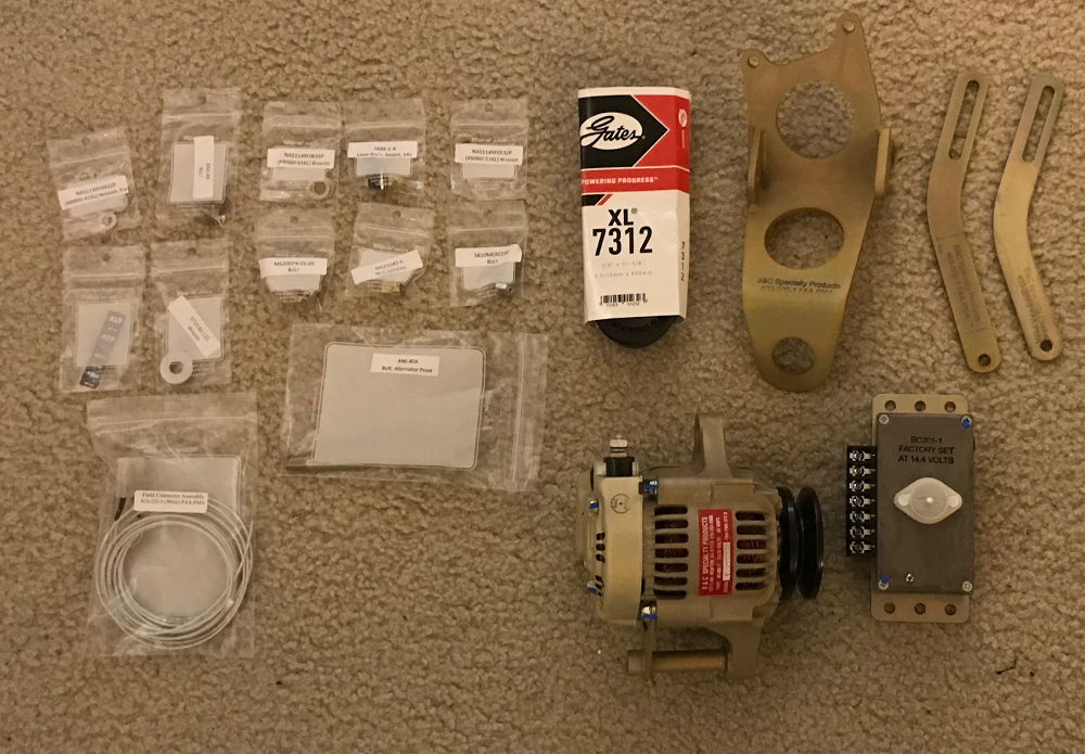

Well after all this I wasn't able to get my current system working. And after the government shutdown I finally got verbal approval from the FSDO for the field approval of the B&C Alternator kit. Fingers crossed it'll be installed on Friday and I'll be airborne again.
I have to say I'm very impressed with B&Cs attention to detail, documentation and customer service. I'll keep you guys posted on the progress, and I'm happy to share my signed 337 if it helps anyone else in my situation.
