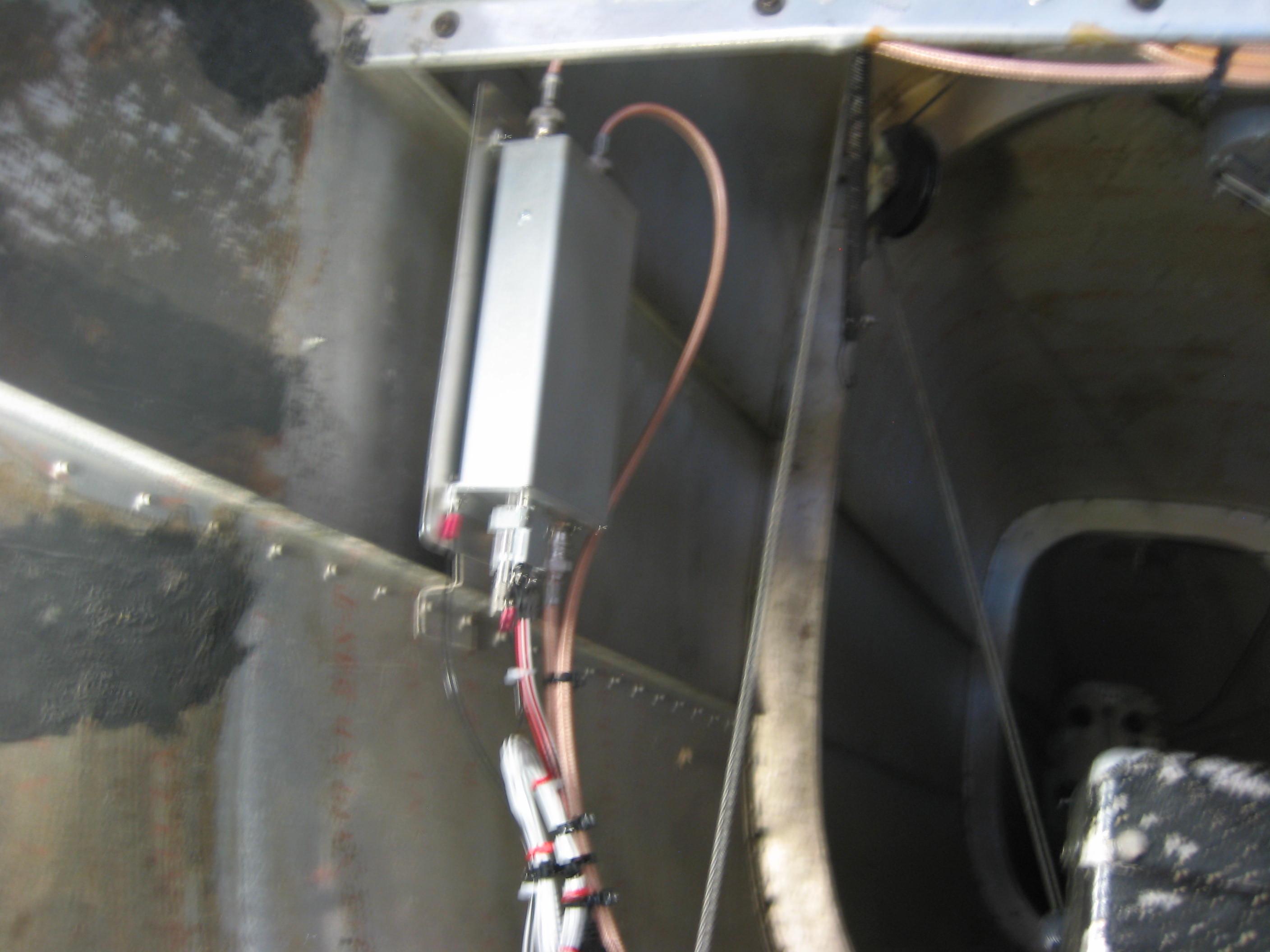

When we did the GDL-82 install on the 140 I considered (briefly) utilizing part of the old coax...then, realized that we'd need to use "new" for the GPS antenna as well as to/from the Garmin unit itself anyhow, so it just made sense to upgrade completely. This is a very dependable and "permanent" ADS-B installation and the new coax helps ensure a "clean", complete & squawk free operation. I suggest spending a "few" more bucks & going with their recommendation. Mac
IMG_0562 (1).JPG (341.68 KiB) Viewed 5859 times
