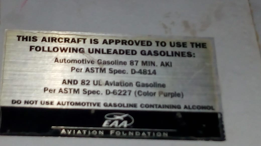

Hello Daniel,
I have had the EAA auto fuel STC for some time and, have used it for years with Shell Premium MOGAS. Very satisfied. No fouled plugs of course.
No high Pb contents in the annual metallography oil checks. If you use 100LL Pb in oil will go to the stratosfere.
I have Marvel-Schebler.
No modification at all in the plane, not in engine neither in the airframe.
Was for me just paperwork, plus signatures, plus adding the STC Documents to the flight manual.
But... Two decal placards,provided with the STC, are stick near your fuel caps warning you about the gas normalisation.
It is clearly stated that you must use only MOGAS (C + H molecules) and no oxygenated molecules. So Alcohol is prohibited.

- EAA-STC-Placard.jpeg (45.19 KiB) Viewed 5743 times
