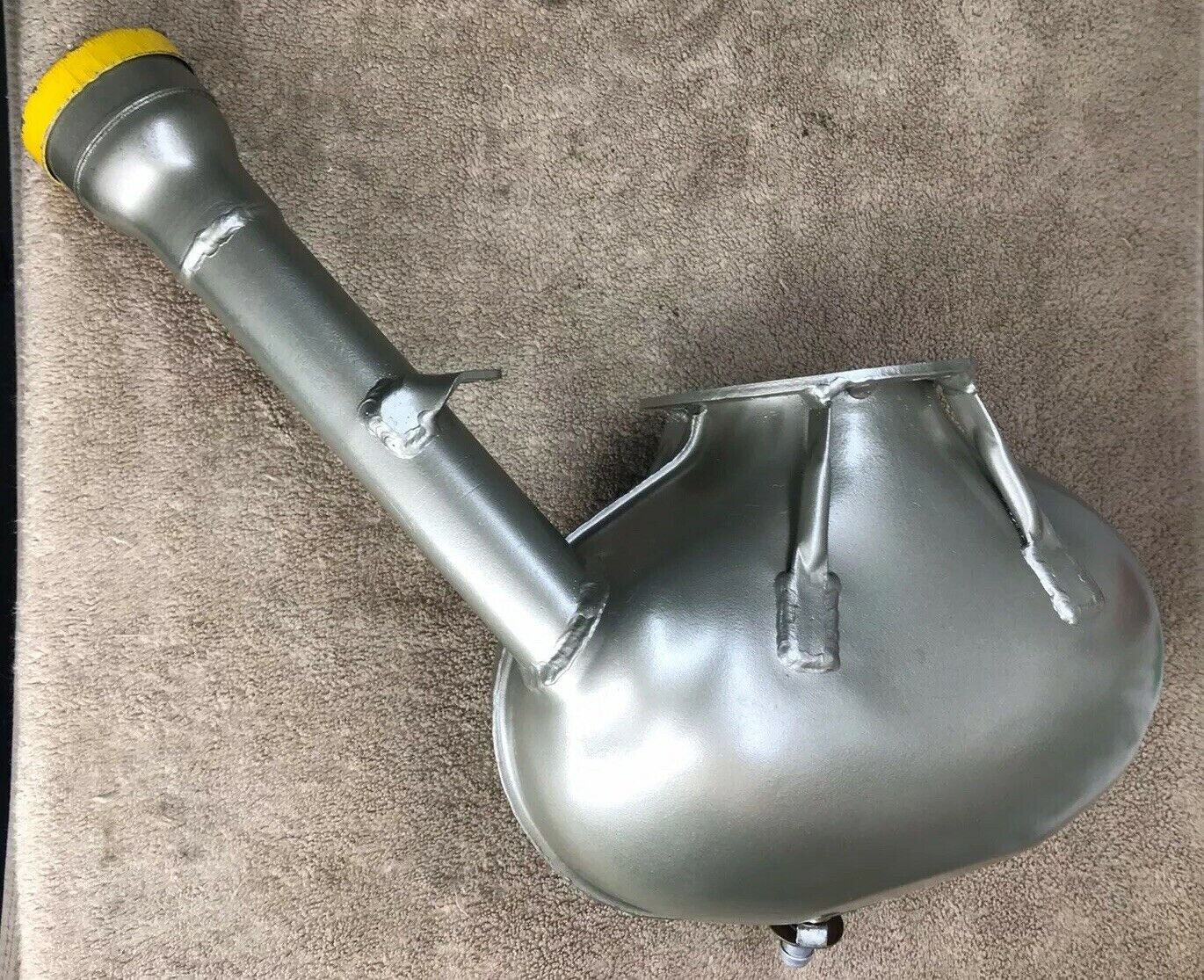

dkshply wrote: ↑Fri Apr 24, 2020 2:07 pm And if anyone has a long neck version, I’d love to take it off your hands.
There's one on Ebay that may work, 'though may not be "the" correct #(?). It's item 303510329680. The indication is that the capacity is 4.8 qts....and it does have a long neck. If your IA (or, you) agree that it can be a replacement, an extra nice "feature" (IMO) is the "braces" that are attached from tank-to-flange and may help prevent (almost inevitable) cracks around the flange. The tank pics really look good. And, no, I'm not the seller nor do I know who it may be. Mac

Re: Oil kidney reservoir
Posted: Sat Apr 25, 2020 7:52 am
There are two basic tanks, the 5 quart tank and the 6 quart (wider) tank. The 6 quart tank is used on all O200s (as far as I know) and commonly referred to as an O200 tank, although there are C-series installations that came with this tank. Then, there are long neck and short neck variants. The neck can be at different angles, to accommodate different mounting concerns. Then, there are the left hand and right hand variants (which side is the neck on?)
Any 5 quart tank can be a 4.5 quart tank or a 4.8 quart (etc.) tank. The capacity is "determined" by what is stamped on the cap. The dip stick markings also have to match the length and angle of the neck. The capacity is determined by the airframe manufacturer. Going from memory, the capacity has to be such that the engine will cool properly with half the specified amount, e.g. 2.4 quarts if you have a 4.8 quart capacity, so, the minimum is determined for a particular installation, then doubled to arrive at the capacity.
The one on Ebay has "O200" style braces added to the neck, a good idea except it makes getting the nuts on and tight a PITA.
Posted: Sat Apr 25, 2020 9:49 am
John wrote: "...makes getting the nuts on and tight a PITA"
Good reminder. I hadn't thought of that added "feature" -- it's already enough of a PITA to get the nuts on/off & "torqued "on the tank without added braces IMO :) . Mac
