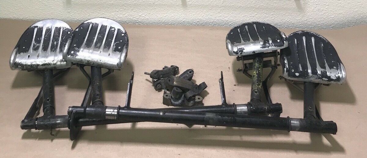

Re: Single to dual brake pedals
OK guys, dumb question time. Are there still only two springs when you convert the single brake set of peddles to the dual? Or are there four? The parts manual only shows a diagram of single brake peddles and the forum Cessna Reference Manual has nothing at all. Reason I ask is that the set I purchased is missing the spring with the long hooks and its attaching clip (see attached pic). Can I just migrate the existing springs on my single set or do I need more than two springs? Any help is appreciated.
There will only be two springs. The 150 bearing blocks are the same.
