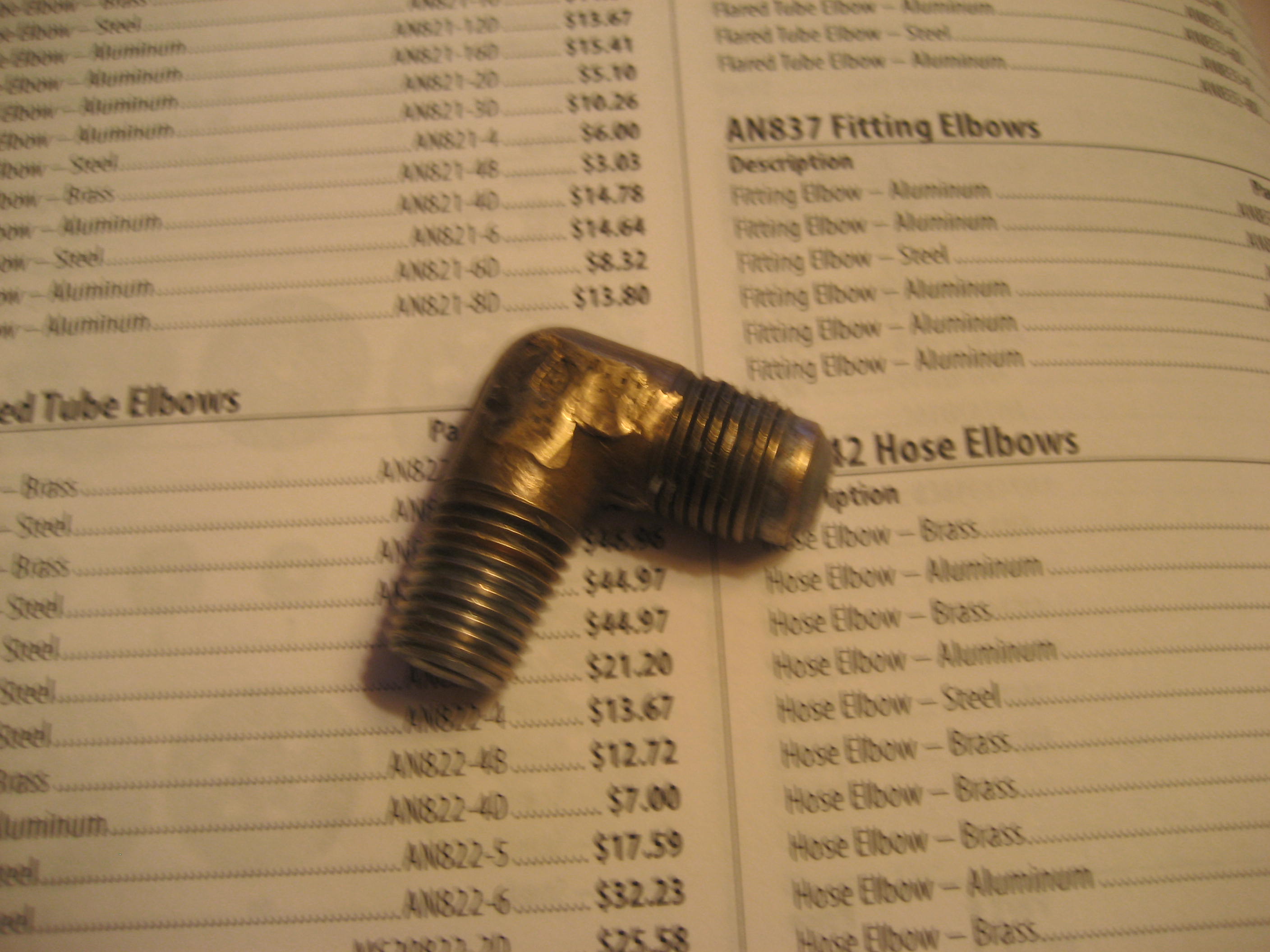

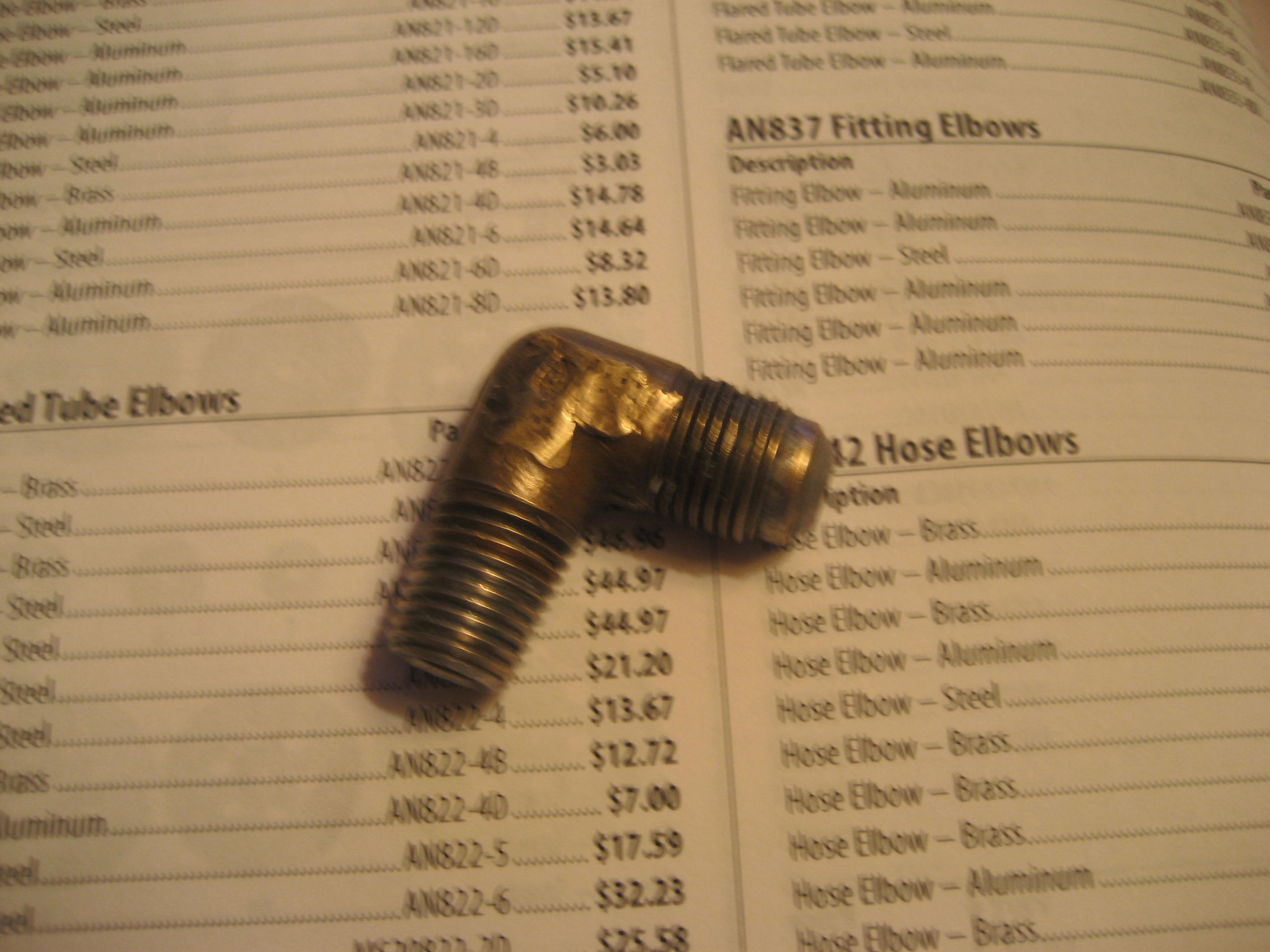

The parts catalogue specifies a AN822-6B for the fuel line-to-carb (Stromberg) connection. Mine is the OEM brass, but needs replacing. ...wondering if it's safe & "legal" to replace with aluminum or steel equivalent? With a quick search of the usual suppliers I'm not finding the brass fittings...except for a used one being sold on Ebay as a "collector's item" :roll: . Mac

Can we read between the lines and note that "collectors item" means "lotsa moola?" As in grandiose price tag? I wouldn't recommend aluminum, I went with steel for mine. I like the additional strength. Make sure you get the proper Aviation flare end.

V529 wrote: Tue May 19, 2020 3:18 pm Can we read between the lines and note that "collectors item" means "lotsa moola?" As in grandiose price tag? I wouldn't recommend aluminum, I went with steel for mine. I like the additional strength. Make sure you get the proper Aviation flare end.
Yep..."collectors" apparently means low (well used) quality & lotsa moola :) . Steel it will be -- thanks! I agree.
Mac

Brass and steel are equivalent. Aluminum is not an acceptable substitute. The brass part would have been AN822-6 (no letter after.) AN822-6S (was) is the steel equivalent. The "modern" part number is MS20822-6. ECAS says that would be steel.

Thanks again, all! I've got a new steel on the way from Spruce. My IA "approves" so probably will just go with it. Mac
