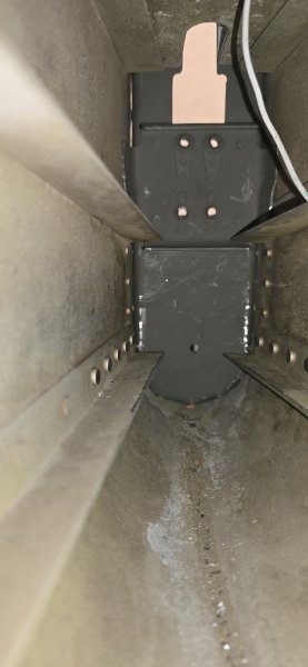

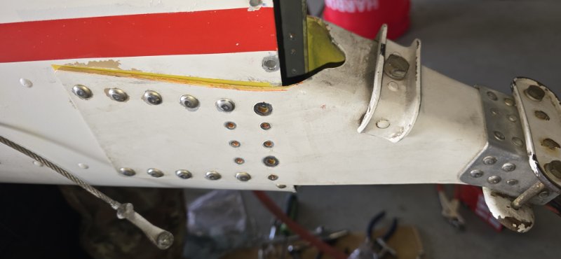

How do you rebuild a tailwheel bracket? It is metal with holes in it, right? I mean, what part of it gets rebuilt?

OK I guess I am just wondering what part of the bracket typically breaks? I wasn't aware this was a problem. Mine looked pretty good but I would have hit it with a magnifying glass while it was off if I had known there were identified failure points

Isn't that a repair underneath the spring shackle?

Yes. So are we supposed to be replacing good repairs? Probably not coming off the plane again for awhile.

atypicalguy wrote: ↑Tue Dec 24, 2024 11:18 amSo are we supposed to be replacing good repairs?
My post was in answer to your question: "OK I guess I am just wondering what part of the bracket typically breaks?"
Not trying to start an argument, but I'm curious how you know it is a "good repair".
Re: Tail Wheel bracket for 140A
Posted: Tue Dec 24, 2024 11:12 pm
by atypicalguy
The original question was "What part of these things typically breaks?" So far, no answers.
If the answer is the part with the doubler in my photo, then it has already been repaired.
If it is some other part that typically fails, i will look at that.
Regarding the integrity of the repair, how do we know if any repair is "good"? To me, if the thing is riveted on tight without any cracks, I would say it is good, provided the correct material and thickness were used. But who am I to say, really. That is why people go to school. So far none of the mechanics who have seen it think it is problematic.
