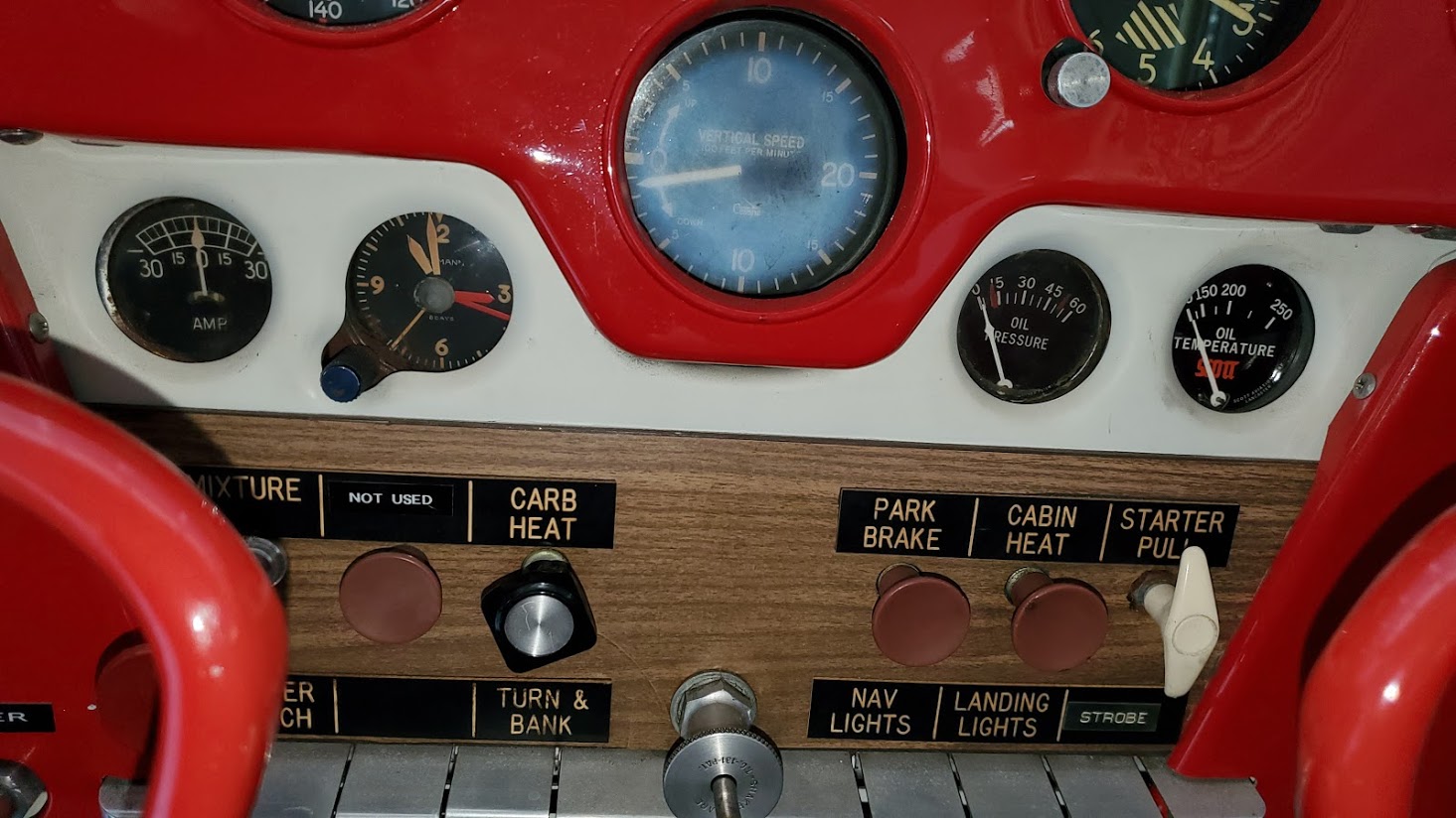

Next item on my list is addressing the VSI on the 140 panel. It's MVFR and descending about 100fpm :lol:
Any recommendations?

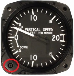

There should be an adjustment screw to stop the decent, probably hidden by the panel.
Looks like it's in a fog; dry it out?

It looked that way since I owned it; approaching a month.
If I could access the back side of the glass it should be easy to clean/dry but I am guessing the instrument is sealed... I suppose I could try a hair dryer.
Re: VSI overhaul recommendation
Posted: Mon Jun 08, 2020 3:54 pm
I don't think it's sealed; I think the case is connected to the static system. (IIRC, that's the glass to break when your static system ices over in IFR conditions.)
VSI adjustment.jpg (29.59 KiB) Viewed 4556 times
