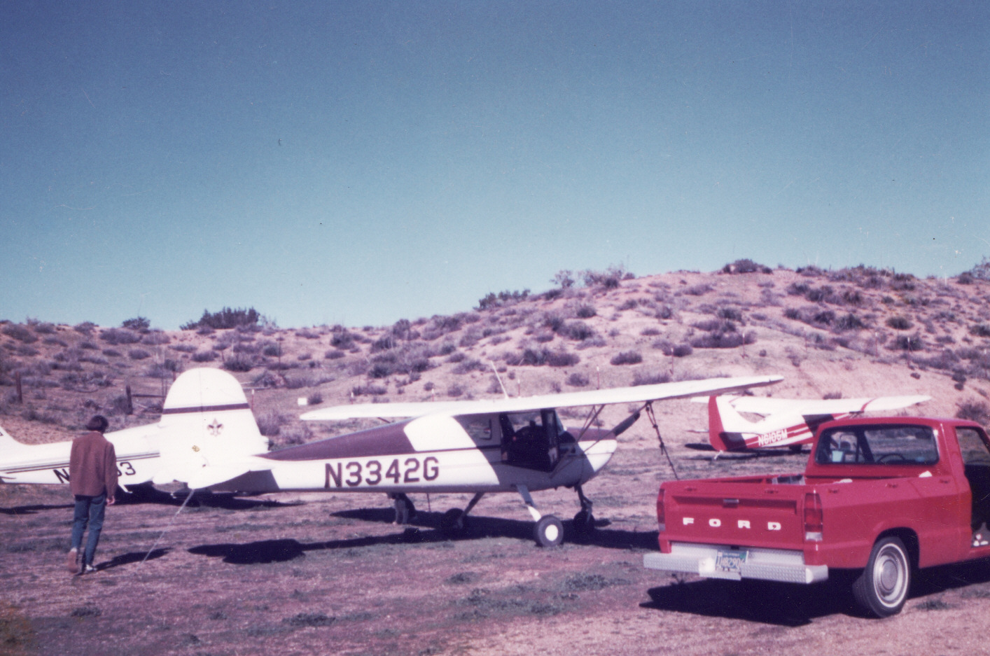

by 6298
Here is a picture on one I had that was a nosewheel airplane years ago.
- Olea.jpg (412.12 KiB) Viewed 5485 times
