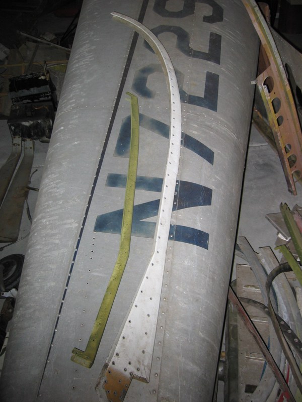

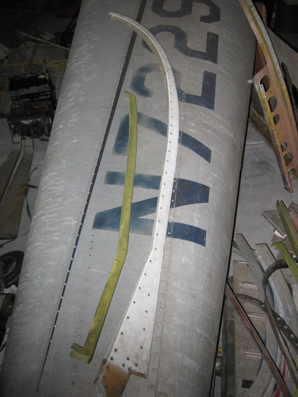

Regarding the oilcanning on the stabilizer, some do and some don't. I installed the 0432160 reinforcements on my stabilizer, I think some of the early ones did not have this.
channel and leading edge.jpeg (98.23 KiB) Viewed 7134 times
As far as the right strut not 'feeling' right, make sure it's a right strut and not a left one on the right side, see previous posts viewtopic.php?f=7&t=1110
I actually had a hangar neighbor with 2 left struts, couldn't seem to convince him of the error.

Went back to take another look at the stabilizer canting problem. The owner and I removed the fairing between the vertical and horizontal stabilizer which revealed the top section of the horizontal stabilizer. This is the section that produces the oil can sound. No cracks, fractures, loose or broken rivets. I think the “00432160 reinforcement will solve this problem. Where does it go, would you have a picture and where can I get one?

Your IA should have a borescope to see if the stab reinforcements are already there, it's a ton of work to install them so make sure you don't already have them. I think I got mine from Univair years ago. See my previous pic as to their orientation. I'm going to presume your IA has gone thru all the Service letters and AD's regarding the tailfeathers and all check out (see Resources tab on main website page). My stab rebuild by Tim Mix in Oregon worked well for me.

Sorry I didn’t pick up on photo of the reinforcement pieces earlier. I was looking at the wing they were sitting on instead of the pieces. Attached is a partial shot my empennage. I think the leading edge reinforcement is incorporated in my tail surface.
