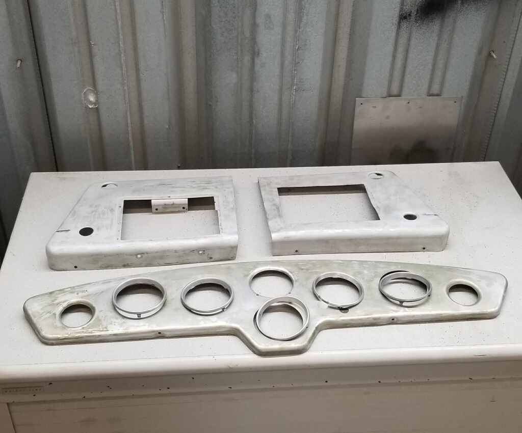

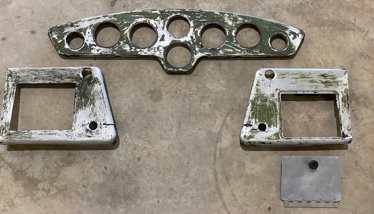

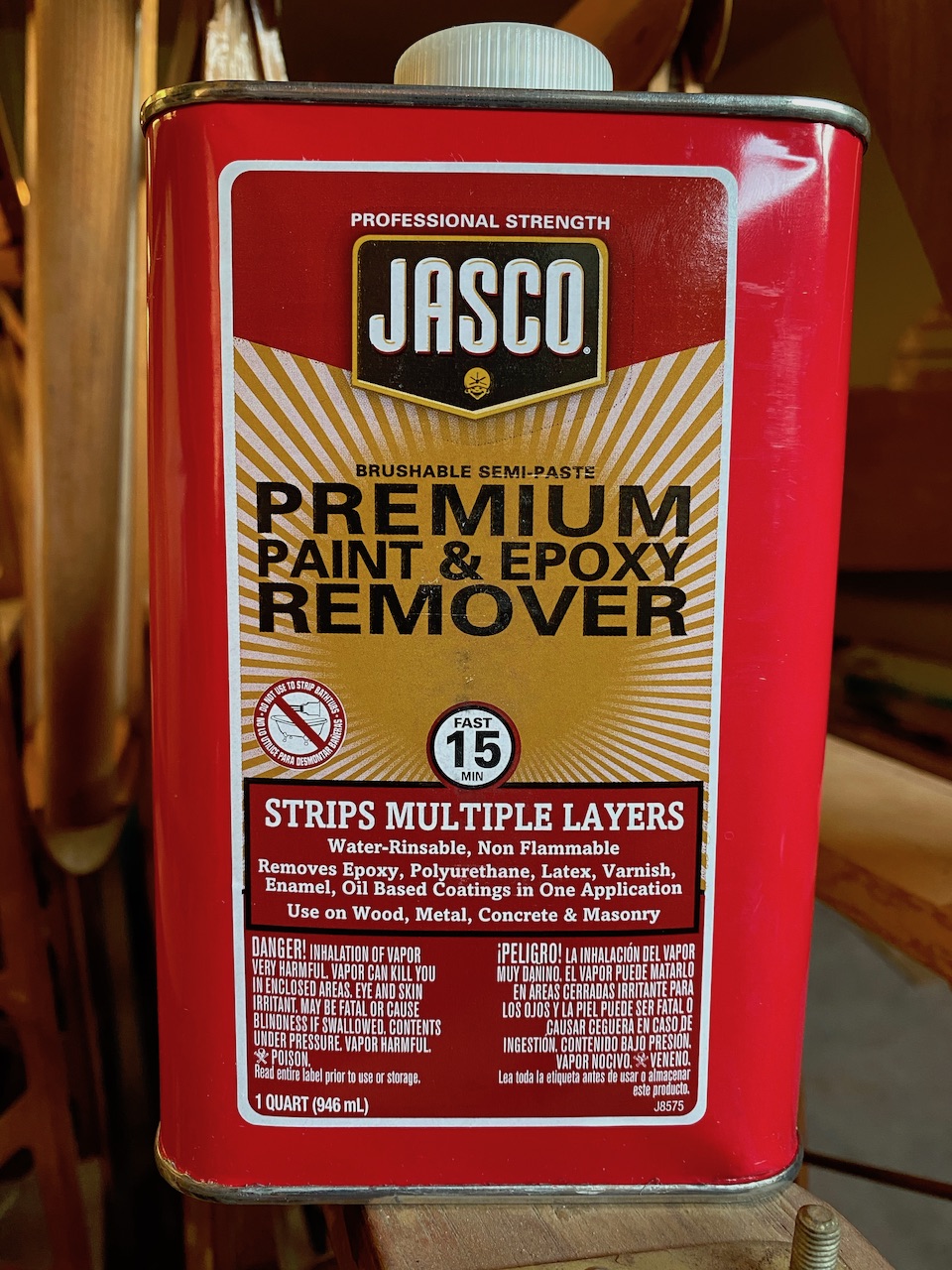

I had / have the same issues. Had to plastic bead blast the instrument panel covers. On the gear legs, struts and other metal areas, we are just smoothing it out and painting over it. So far, we've been able to get all the paint off the fuselage and control surfaces with JASCO Premium Paint & Epoxy Remover. You can see the details of that in 'The Rebirth of Cessna 140 NC3771V' thread in the Member Aircraft and Project Showcase.
After stripping
After Plastic Bead Blast
The plastic beads reduce the weakening of the Alclad surface. Steve

regular122 wrote: Mon Jul 20, 2020 3:04 pm I had / have the same issues. Had to plastic bead blast the instrument panel covers. On the gear legs, struts and other metal areas, we are just smoothing it out and painting over it. So far, we've been able to get all the paint off the fuselage and control surfaces with JASCO Premium Paint & Epoxy Remover. You can see the details of that in 'The Rebirth of Cessna 140 NC3771V' thread in the Member Aircraft and Project Showcase.
Where would I find the Jasco remover?
I was not able to find it on Amazon.
What does the can look like?
Re: Primer stripper
Posted: Mon Jul 20, 2020 8:53 pm
by regular122
Looks like this if you can find it. Steve
Re: Primer stripper
Posted: Mon Jul 20, 2020 10:04 pm
by 6183
8342 wrote: Mon Jul 20, 2020 6:36 pm Where would I find the Jasco remover?
Home Depot
