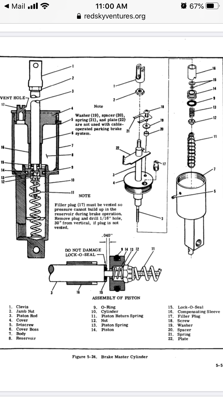

Another thing to check, depending on the brake model you have, is the clearance between the piston rod and piston. See attached diagram, it should be set to .040" My understanding is that this gap allows the piston to 'lag' - to allow displaced fluid to return to the bottom side of the piston. A new o-ring (Lock o Seal) and setting this clearance to .040" fixed a spongy/non-leaking brake for me.
- Brake .040.png (405.11 KiB) Viewed 11700 times
