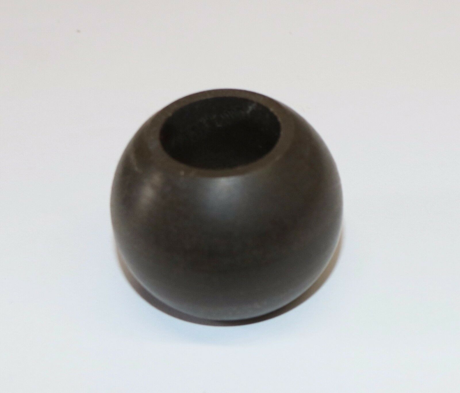

FWIW, @ Ebay: Item # 264552689277. $ 0.99 each, 4 available (I'm not the seller).
Mac

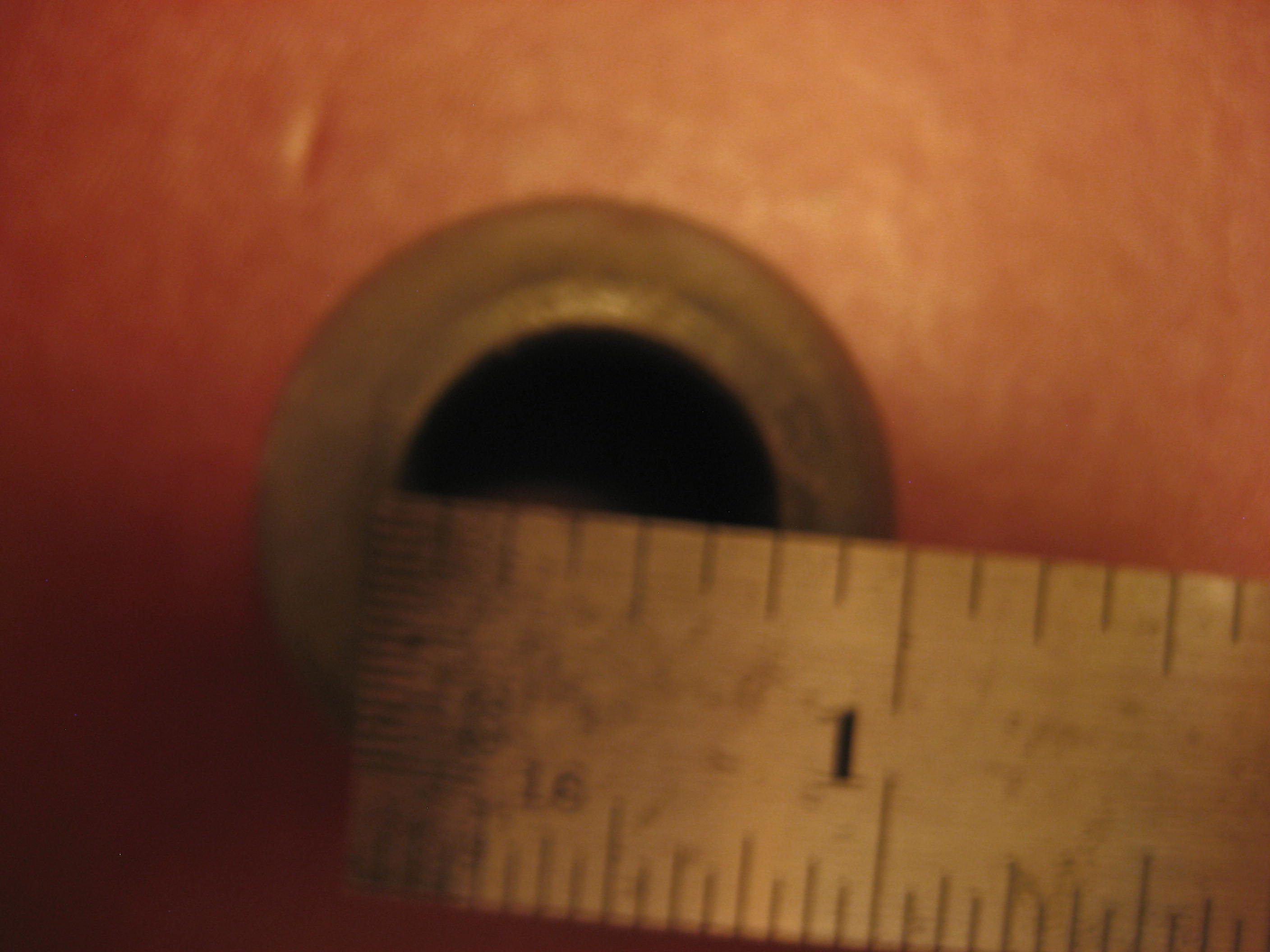

Thanks for the Ebay find. The seller says the I.D. is 1 inch. The ones in our planes have aprox. 3/4 inch I.D. Mine are .780...probably a little oversized due to 70 years of wear! The control wheel shaft is .750.

His measurements may be approx guess(?)...in any event, they fit mine perfectly/same size as my old ones (were in 1946). FWIW -- I'm not selling anything :D . Mac
