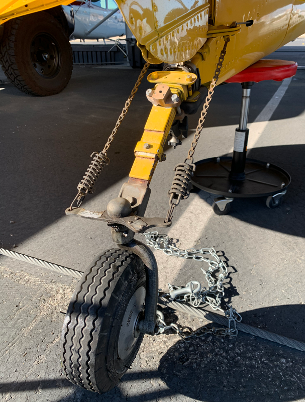

Re: Changing a Tailwheel Tire
I use my shop creeper seat. Works great. Just put it under and raise the seat as I gently pull up on the pull handle.
Tamer, just curious, what’s that extra bracket for?
8359
- Posts: 235
- Name: Tamer A
- Location: KSNA
It's a camera mount from flight flix:
