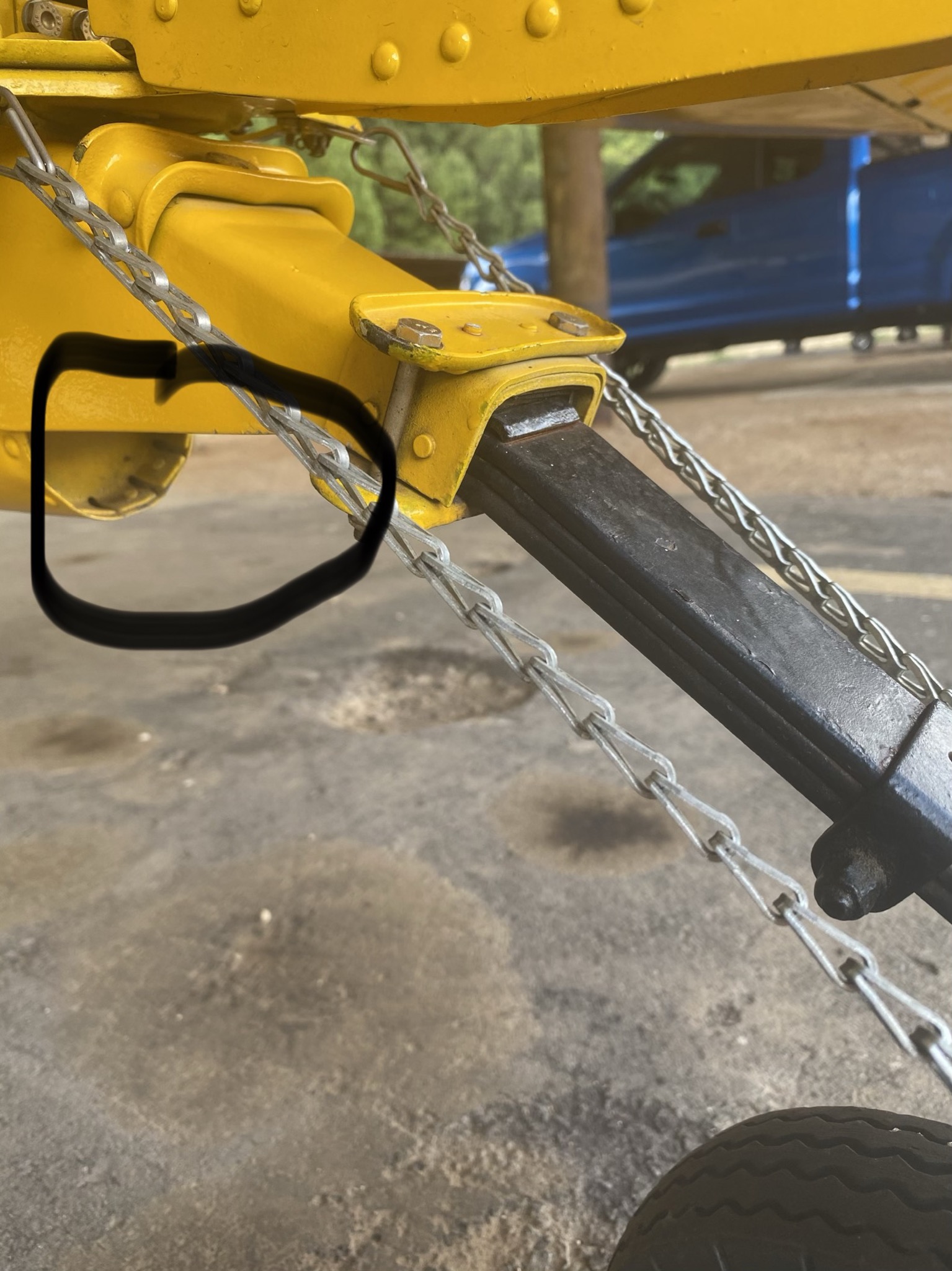

Tamer, just curious, what’s that extra bracket for?
Re: Changing a Tailwheel Tire
Posted: Mon Aug 03, 2020 2:19 pm
by 8359
It's a camera mount from flight flix:
https://flightflix.net/product/rock-ste ... all-mount/
It's a nice angle, although the camera get's pretty dirty off airport!
