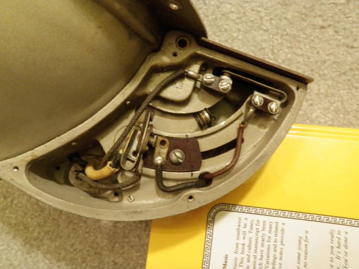

Read the article. There are limit switches in the housing that often get oxidized contacts.

Re: Landing light stuck down
Post by 6597 »
Here is one example of the limiter contacts. If you stare at it long enough you can figure it out. Contacts need to be cleaned, and may need adjusting. Wiring may need some TLC, you won't know till you open it up.
