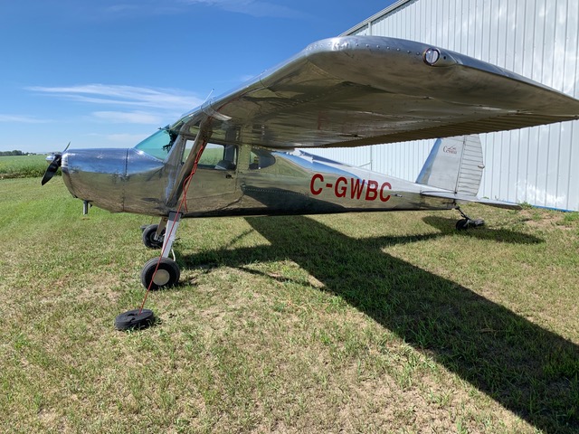

I have stripped and polished my airplane and will be having it wrapped in pretty much the original scheme. That won't happen until this winter some time though so can't tell you how it goes just yet.

I don't plan on wrapping the whole airplane. Just some of the cowl and the 2 stripes down the side. I also need to do the leading edge as I had to body fill the hangar rash there. I just had the shop that is going to do the wrap do my registration and it is pretty smooth and shiny, no holes in the vinyl at all.

Smaller, especially on flat surfaces are easier. I don’t know how well you can see it, but my registration numbers on the wing are red Vinyl, and while I believe it may have microscopic holes it’s smooth, larger sections wouldn’t be.

The shop that did my reg is an experienced vinyl shop, they do all sorts of very complex curved surfaces for cars and trucks so I'm not concerned about them doing the cowl.
I will have to have a really close look with a magnifying glass to see if there are microscopic holes or not.

For whatever it’s worth, and I am not the FAA police, but vinyl N numbers do not meet the requirements of being “permanent”
A decal, whatever the difference is, does.
So if asked, call them decals I guess :)
The vinyl N numbers on my wings are not N numbers, they are from a legal perspective just part of the paint scheme of my airplane.
I manufactured airplanes for a long time, and towards the end of my work, the manufacturer was putting on N numbers for US Registered aircraft in Vinyl, although I advised them it didn’t meet the FAR’s.
I always had on the aircraft that were being exported as they were temporary N numbers.
On edit, just realized your a Canadian aircraft, so I don’t know what your regs say.
We got ours made by the local car “Speed Shop” they also made the larger ones that I put on my wings.
Vinyl from shops like that will most likely be just plain ole vinyl, with no holes etc, they I believe laser cut it from material on a roll. But if you go to a shop that specializes in vinyl wrapping boats and trucks etc, they can computer print graphics etc. on the vinyl, that’s when you get the special vinyl that’s much thicker, stretchy and has either holes or channels in the underside of it to let air out. Can you imagine trying to lay vinyl on a whole automobile without any air bubbles?
