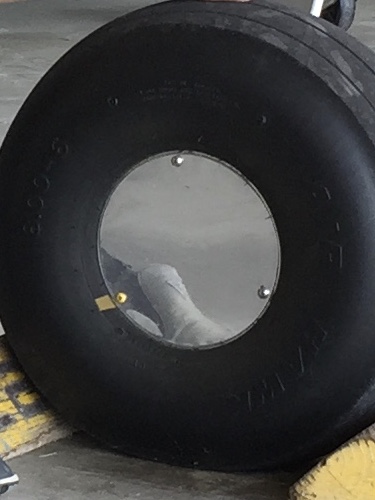

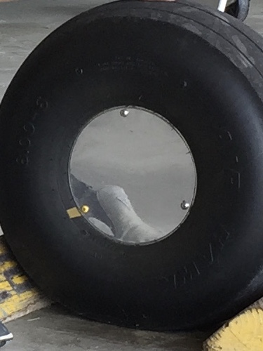

I have 800-6 tires but my A&P doesn't know what is the max psi? There is nothing listed on the side of the tire. Do you know what PSI they should be inflated?

Ok I realized I asked the wrong question.. what I am asking is what is the normal tire pressure of 800-6 6 ply tires on a Cessna 140?

16# works fine for me on my 800's with no extenders/straight legs. If I get in a dither I put 18# in for mostly asphalt, makes me feel like I unstick a little quicker but who knows. 800's are nice on grass and the beach up here but some folks think they slow you down a little bit.

I don’t think there is a normal pressure, it will vary with aircraft weight, but assumption is if your wearing big tires that your after floatation, and that comes with low pressures. You want some “belly” in the tires. That’s where the put air into the tires until the outside groove just lifts off of the ground, and yes I’m aware that Good years for example have far fewer grooves than other tires.
At least bigger and heavier aircraft an issue of running low pressure is that if you get on the Brakes hard the tires will slip on the wheels and that will pull the valve stem out of the tube and you have an instant flat of course.
Some will drill through the screw holes that hold the hub cap on and use longer sheet metal screws that will screw in into the tire carcass to keep it from slipping.

Thayne, I have 800s on my airplane and have run anywhere from 30 to 10 psi in them depending on airstrip surface and what I am doing. Nominal pressure for me is 20 psi. I have also painted witness strips on my tires to check for slippage, particularly at the lower pressures, and have found some minor slippage now and then. The slippage is not from normal runway use but from short unimproved surface use. And by the way, the 120 even without flaps powered by a C-90 riding on 800s does actually make a good bush airplane.
